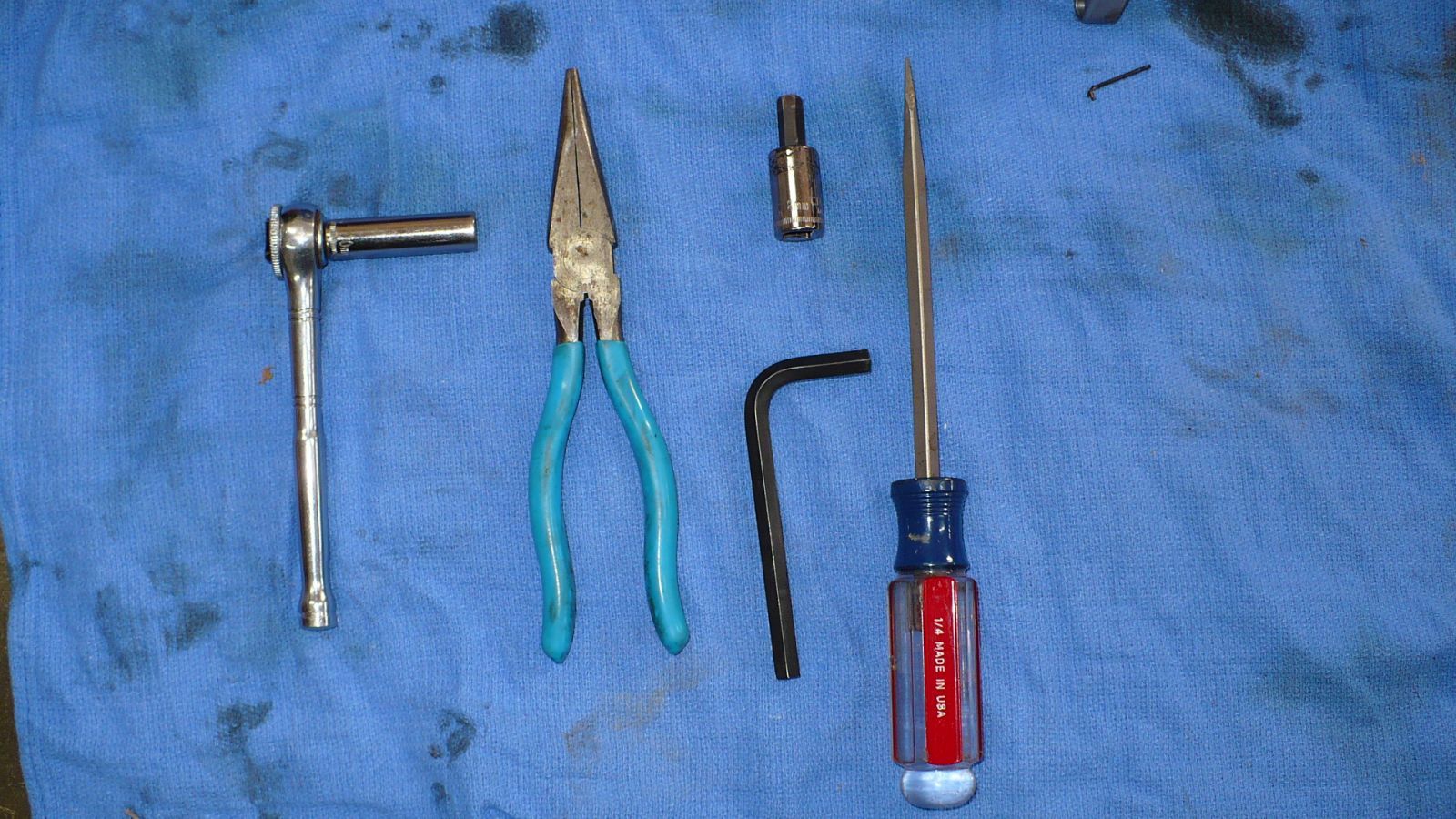

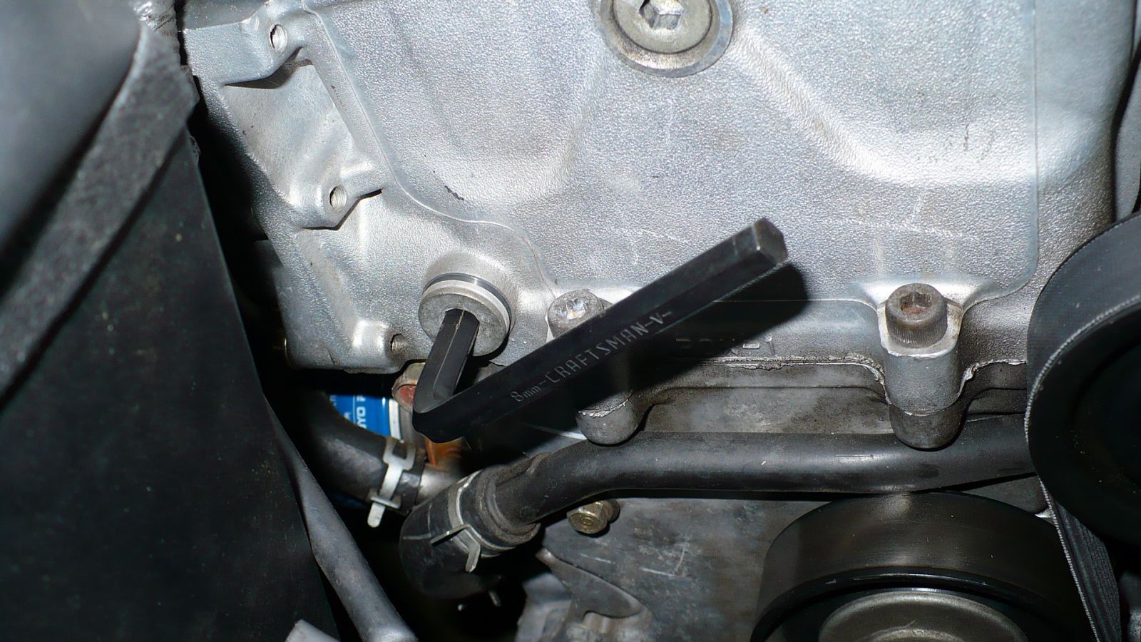

Picture of tools needed:
What the other guy mentions as a T-50 is actually 8mm:
