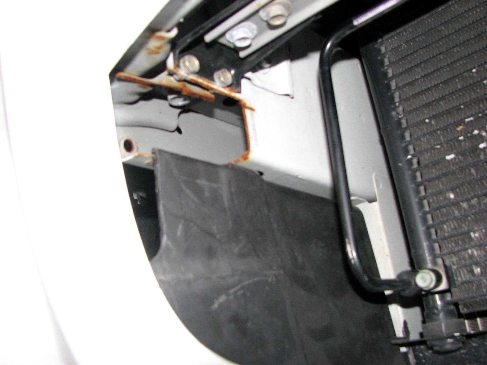

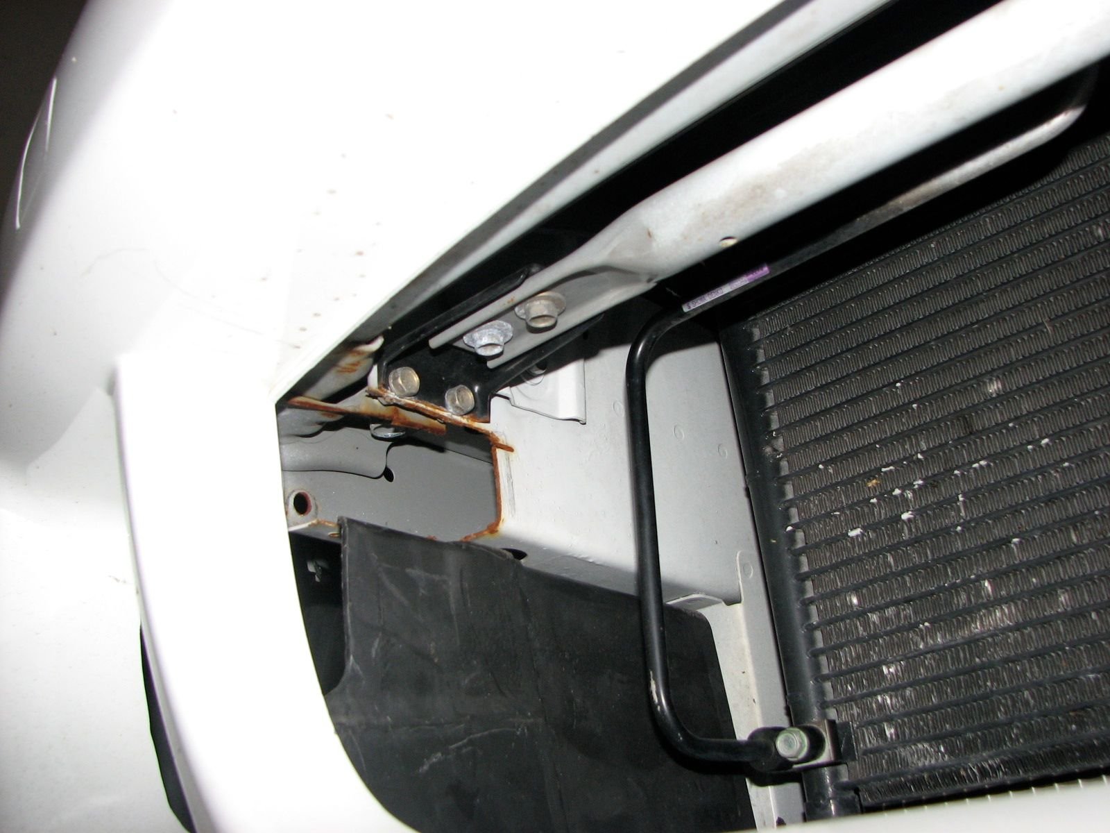

Here are some pics of the car and the "cut". It may be hard to orient yourself - this pic is of the cut on the passenger's side and there's an identical one on the driver's side - note the rust....

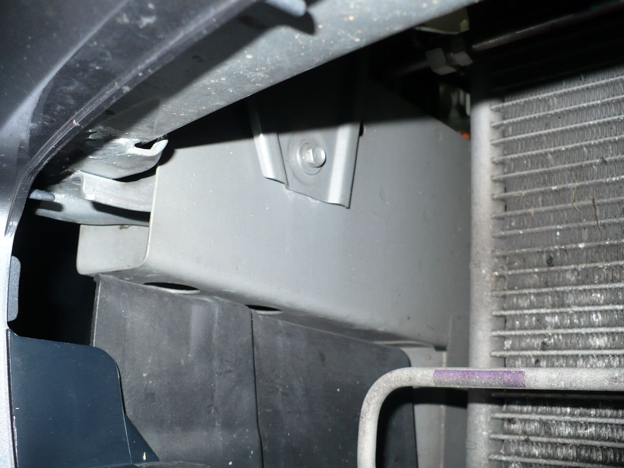

Anyone got a pic of what a "normal" frame should look like?

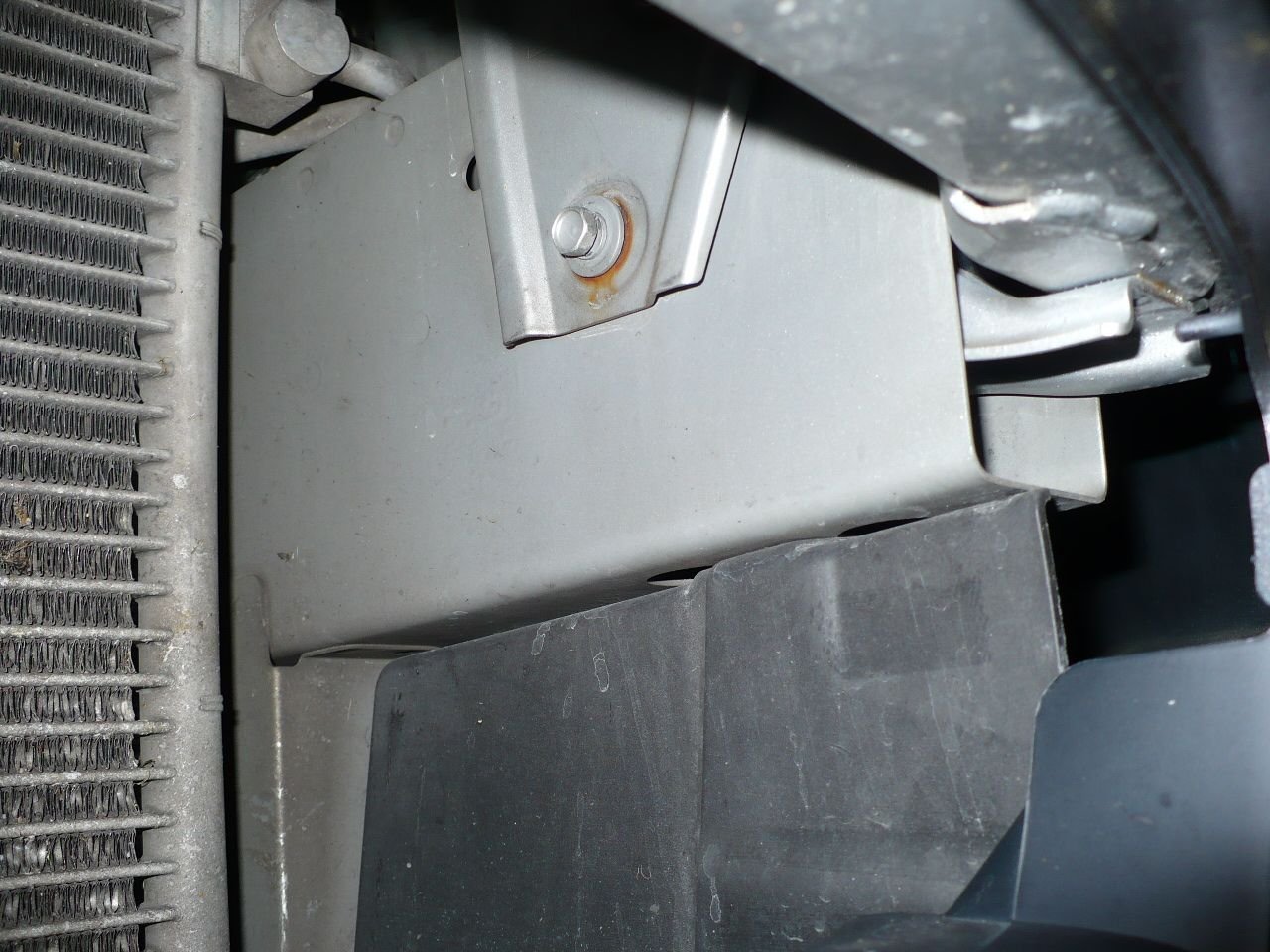

Not much normal about me or my car, but I just snapped these a minute ago for ya. Welcome aboard! We just added a '99 Miata to our stable.
Perhaps an oversized intercooler was on your car previously.

It definitely looks like it was cut by someone..
Thats the first thing that comes to my mind.

Intercooler is the only thing that makes sense there.

I was originally thinking the car had a supercharger as you have to mod the front crossmember to give room for the oil line.
Who ever cut that was good and the car was returned to stock cond, you might want to do a compression/leak down test, even adjust the valves.
Your engine may have been putting out a bit more power in the past.
George

Makes sense to me..other than that "damage" the car is fairly pristine - hopefully the previous owner kept up on all the maintenance - I didn't have a compression or leak-down test done before purchase - I might now, not that I suspect anything but hey, who knows.
Anything else to look for now that I "know" it was FI'd?

FI cars run different plugs, fuel pumps and fuel pressure regulators. Most would have been returned to OEM. If you dont smell gas you should be ok.
Change the diff fluid as FI'd diffs can take a beating.
