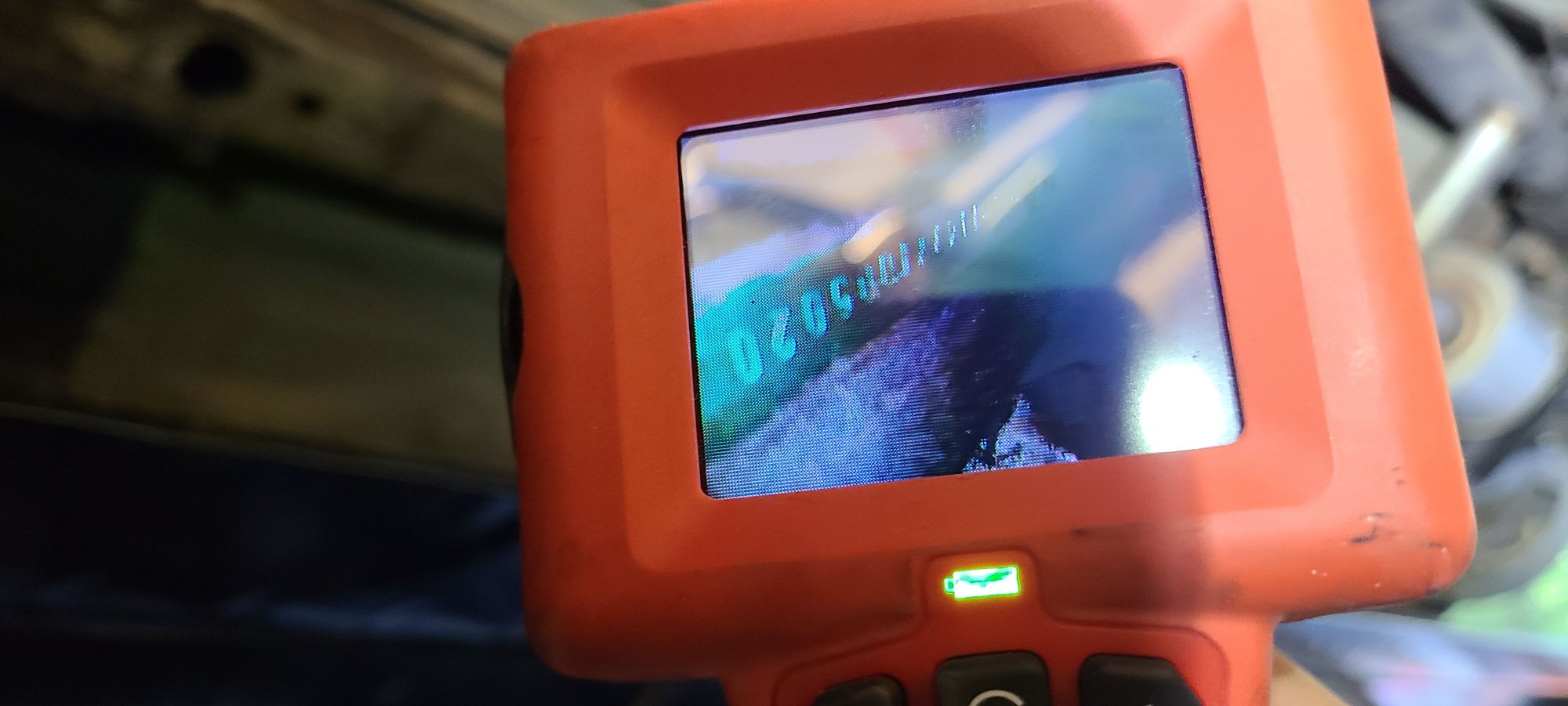

To start, the biggest issue with this car is an undocumented crash. There is one documented hit on the CarFax from 2001, around the time the car was new. However, there is at least one more MAJOR hit that was never reported. The entire front of this car has been replaced, with mismatching fenders, hood and more importantly - the engine. last I recall the engine VIN and the hood VIN are the same - the donor car's VIN is JHMAP1147YT005020. Pulling the info on this VIN, we can see it was a silver S2000 crashed with 119,947 miles in 2015. Both the engine and transmission were swapped, meaning the drive train in this car currently has at least 130,000+ miles, despite what the original odometer states. Further issues:

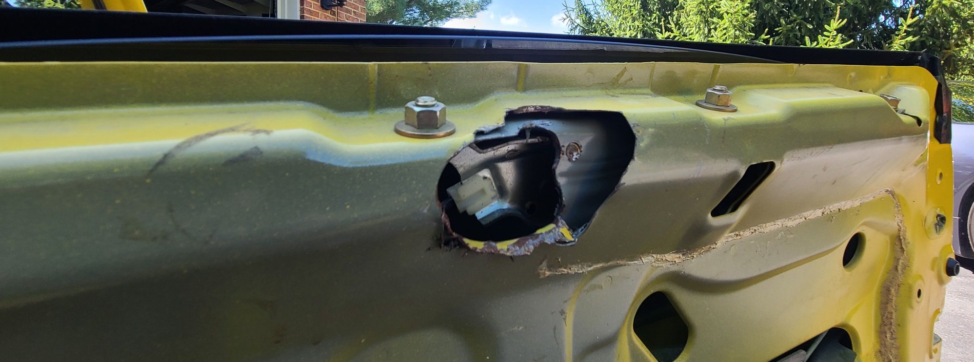

- Someone literally cut GIANT holes in the door frames, most likely in an attempt to swap the window regulators

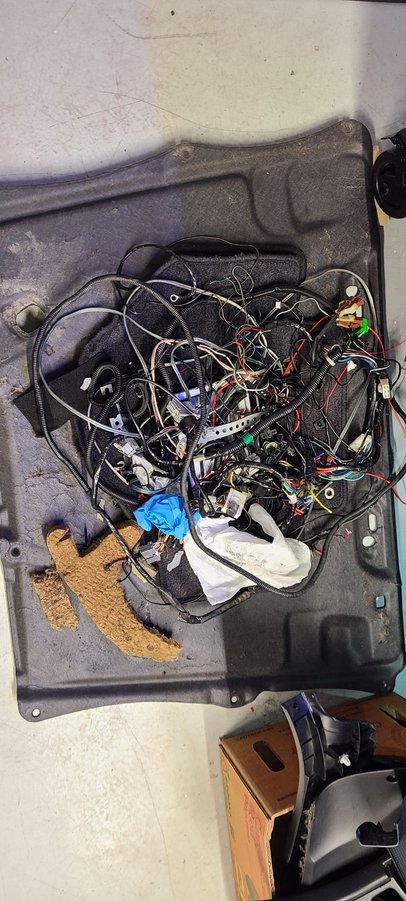

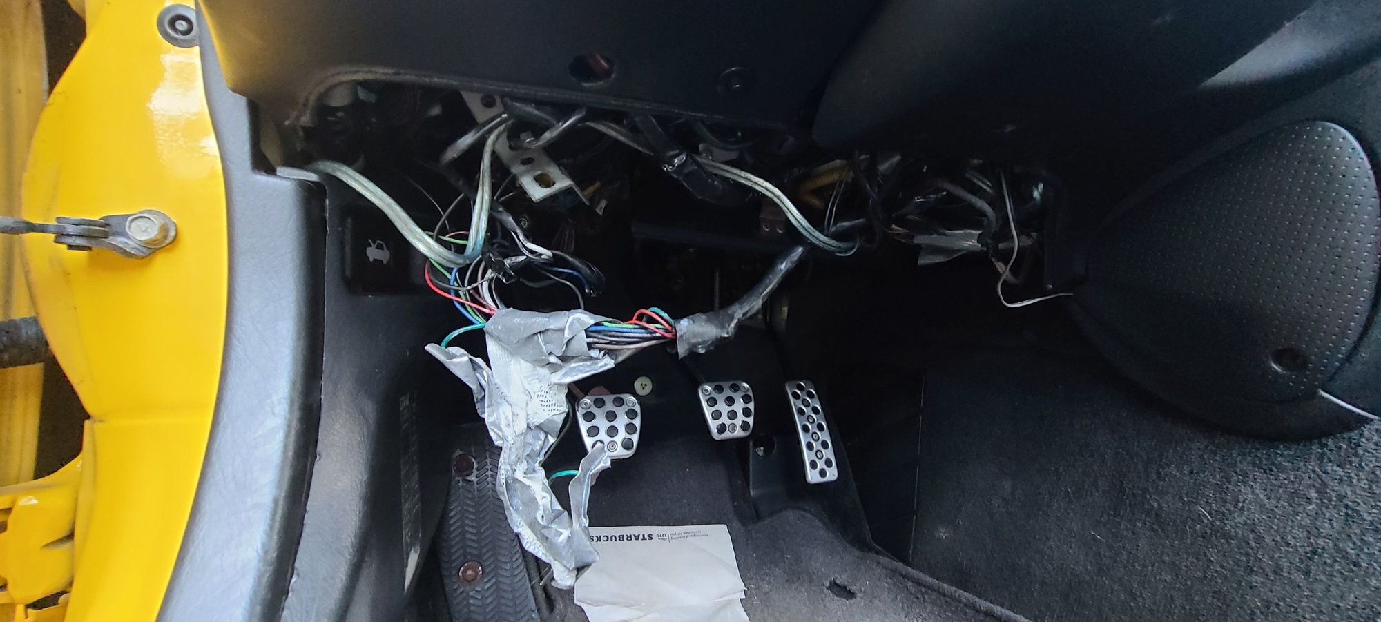

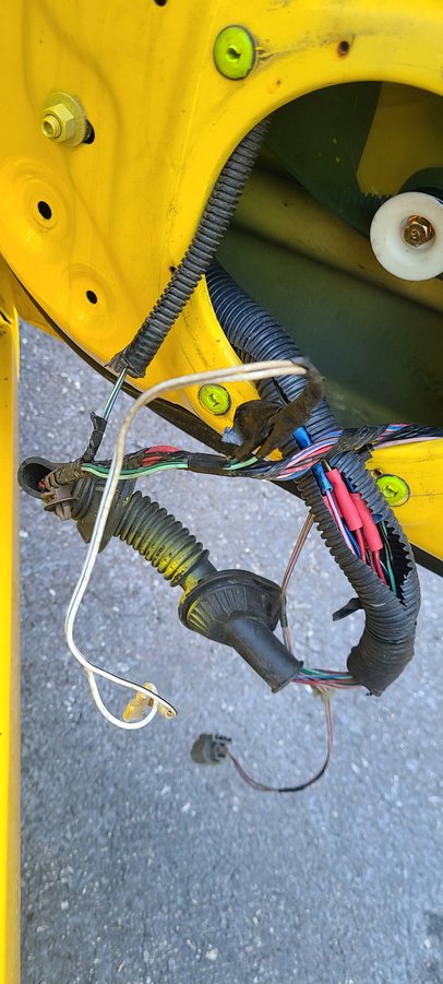

- All the wiring has been tampered with, door harnesses are all cut and spliced for an unknown reason. Power locks do not work.

All of this should be easily provable as soon as anyone looks at the car in person. Last I saw it the engine VIN did match the VIN on the hood, but it's possible someone will remove it at some point. The back of the engine head and the transmission are stamped with the green VIN tag JHMAP1147YT005020 however and can be read with a mirror. I have also attached the VIN reports for both this car and donor car.

Engine VIN: Note the 5020 matching the silver car
Door damage:
Some of the wiring mess: (most of this is removed now) The door panels still have the shoddy splice job.
