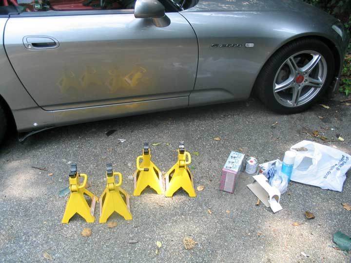

Getting started....
Put the car up on the jackstands.....this was the PITA b/c I couldn't get the car high enough without a hydrolic jack (a must have I now convinced)

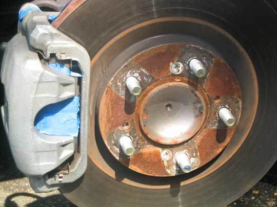

Next preping the wheel (steel brush and brake dust remover, then tape off areas like the brake pad and rotor

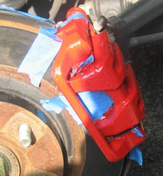

Next was the painting process which required MULTIPLE COATS to get a smooth finish. Sometimes the paint would begin to clump (I added too much hardner).
And here's the finished product...
If I had to do it again I would have a hydrolic jack, and taken the caliper off. In the long run that would have saved time.
-So what do you guys think?
