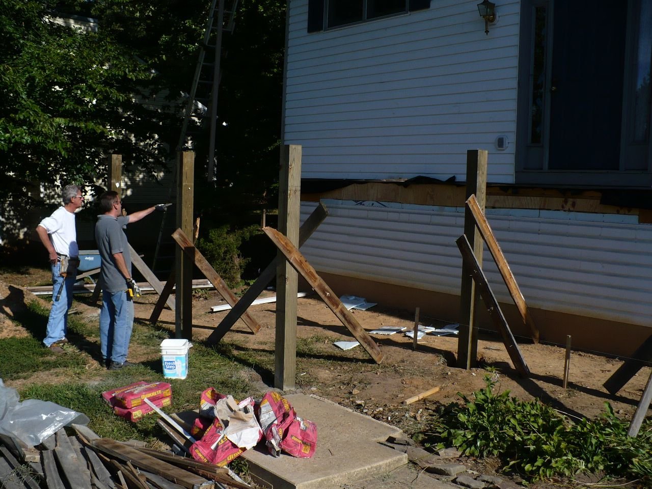

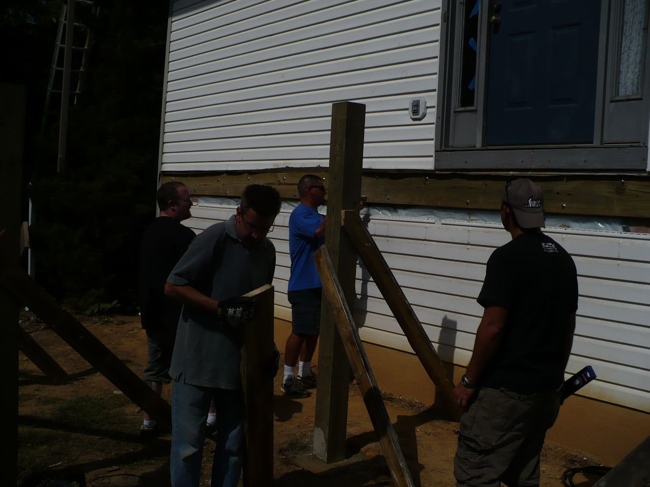

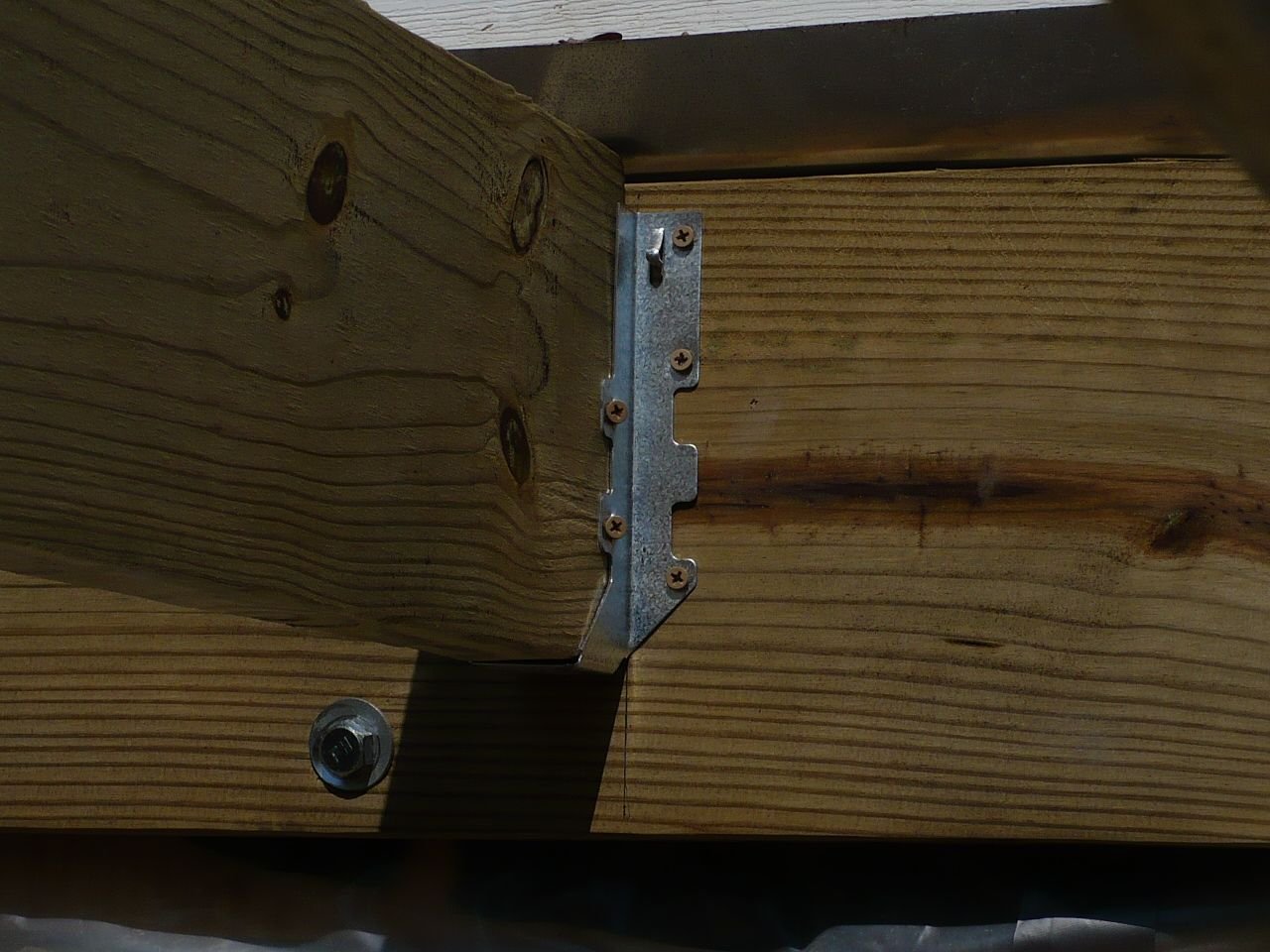

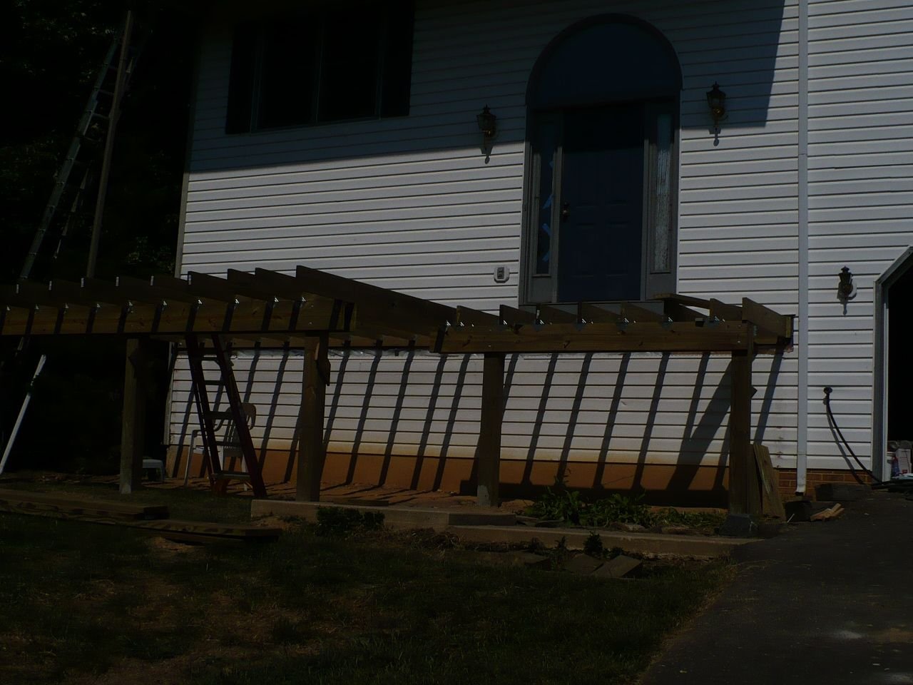

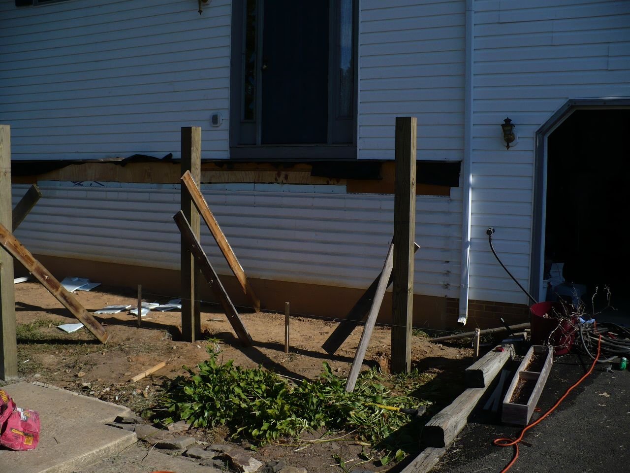

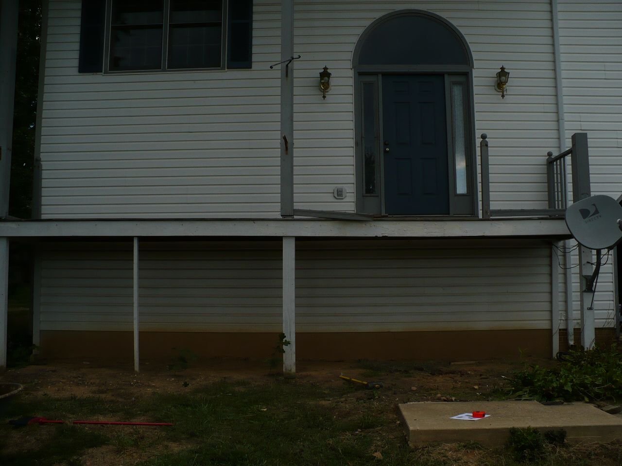

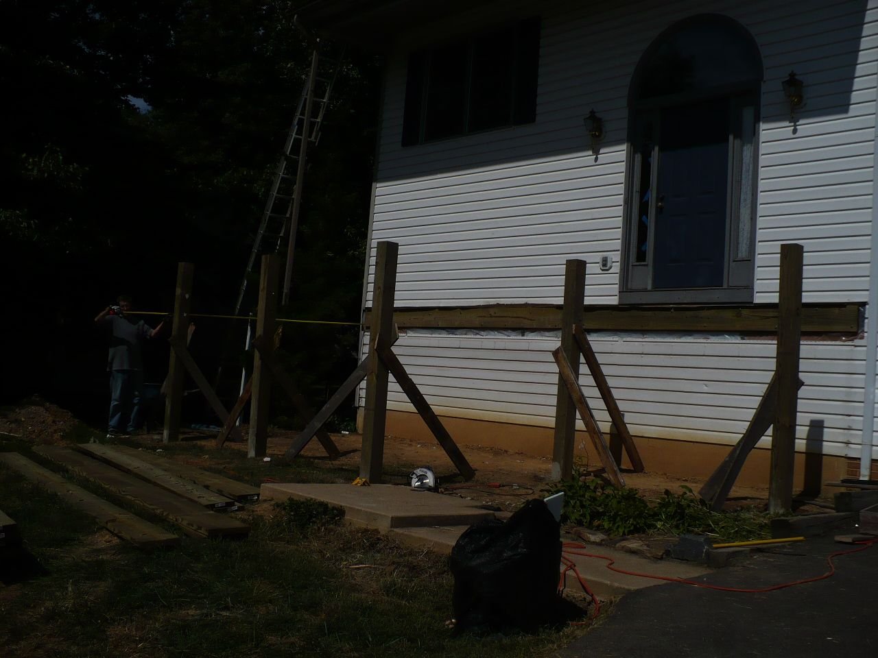

Some quick pics in no particular order... and not up-to-the-minute.

Notes:
No nails used in rebuild.
Previous supporting 4x6's not anchored in any way, shape or form. Just sitting on a 12x12 concrete pad.
One middle support for 24' run on previous.
No railing post in middle for 12' run of railing on previous build.
