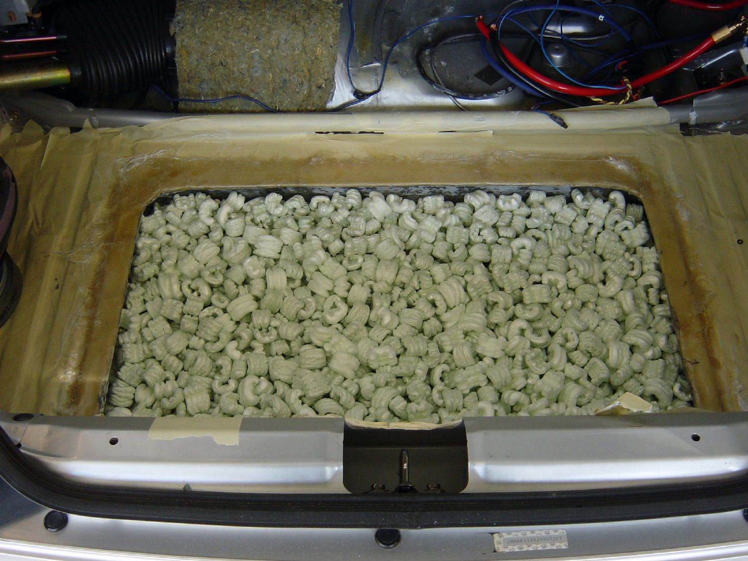

yes, but I thought it was close enough
the JL boxes actually sit lower then my box and they have a little less room, so I think a 12 of the same sub should work ok. I'm not going to be terribly anal about it
Is there a way to measure how much space is in my box, it was custom made so I really have no idea how much space it has, other then it can hold 6 quarts of of mobil one with no sub.

See above pictures with packing peanuts.
As for your box and the JL one... The JL one is made of fiberglass so it conforms more to the shape of the tool well. If yours is of MDF, you will lose some of the avaialble space down there. That said, just because your box sits higher doesn't automatically equate to more volume.

Originally Posted by FF2Skip,Feb 23 2006, 11:33 AM
1.86 cu.ft is shown here.
And I thought you measured it in ice cubes.
