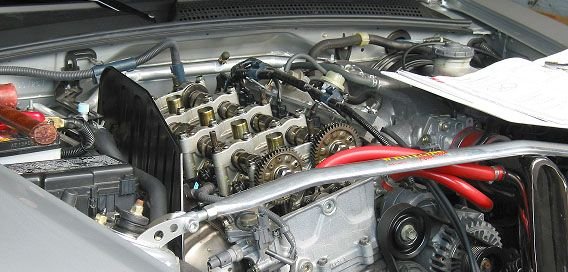

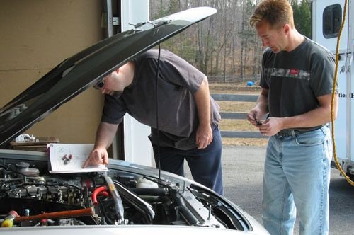

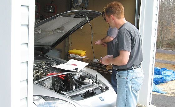

Since Skip posted his effort here, figure I'll post the couple pics I'd snapped during his labors.
