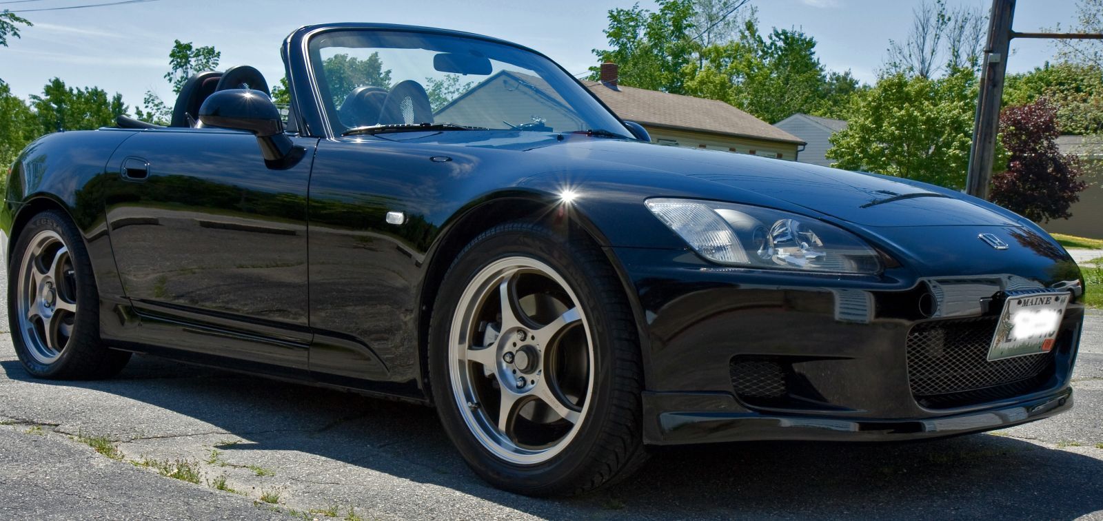

yep easy to open em up. oven at 125 degrees put your headlight on a wet towel on a baking sheet. Pull them out at 10 minutes and take a screwdriver wedge it into the goop get it started just a bit than its all finger work from there. Wear gloves and pull when the goop cools a bit pop it back in the oven and than reapeat. While between visits into the oven use a paint stir stick or equiv to hold what you have spread open to that point open. There are locking tabs that you pull open while the light is hot and those are good starting points for your seperating.
Good luck, a bunch of us have done it we had a big headlight clearing meet last spring at a members house.
thats a pic of mine done, bad pic i know
