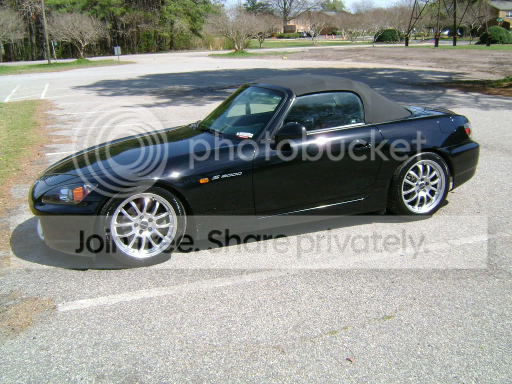

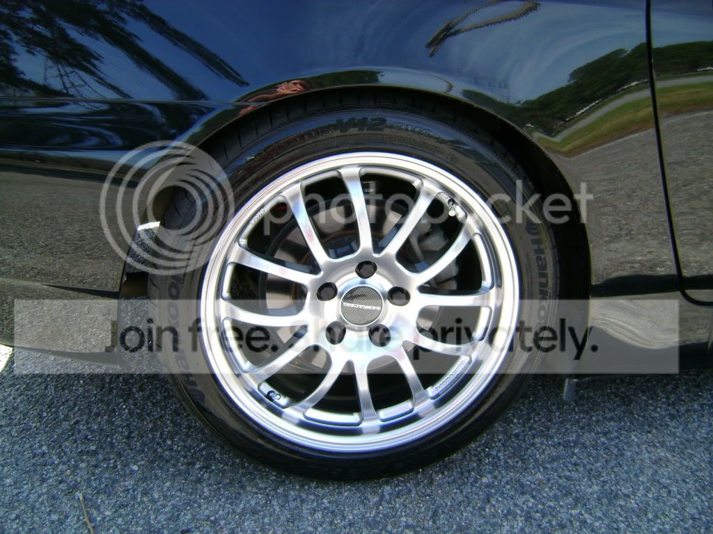

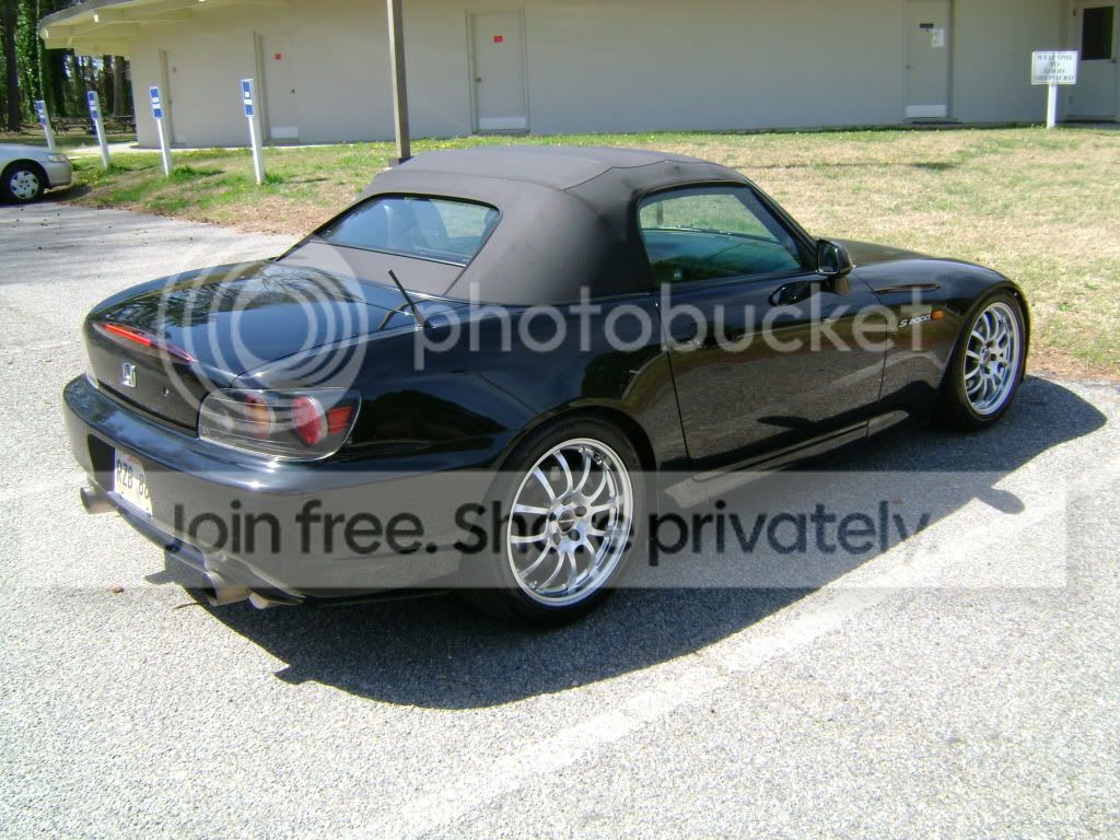

Heres my setup.
Nickel ULR's
17X9+63 Ventus V12 255/40/17 all around
No spacers
I do have my fenders pulled and rolled to be that low.
Color code.......... Duh...... Its Berlina .
