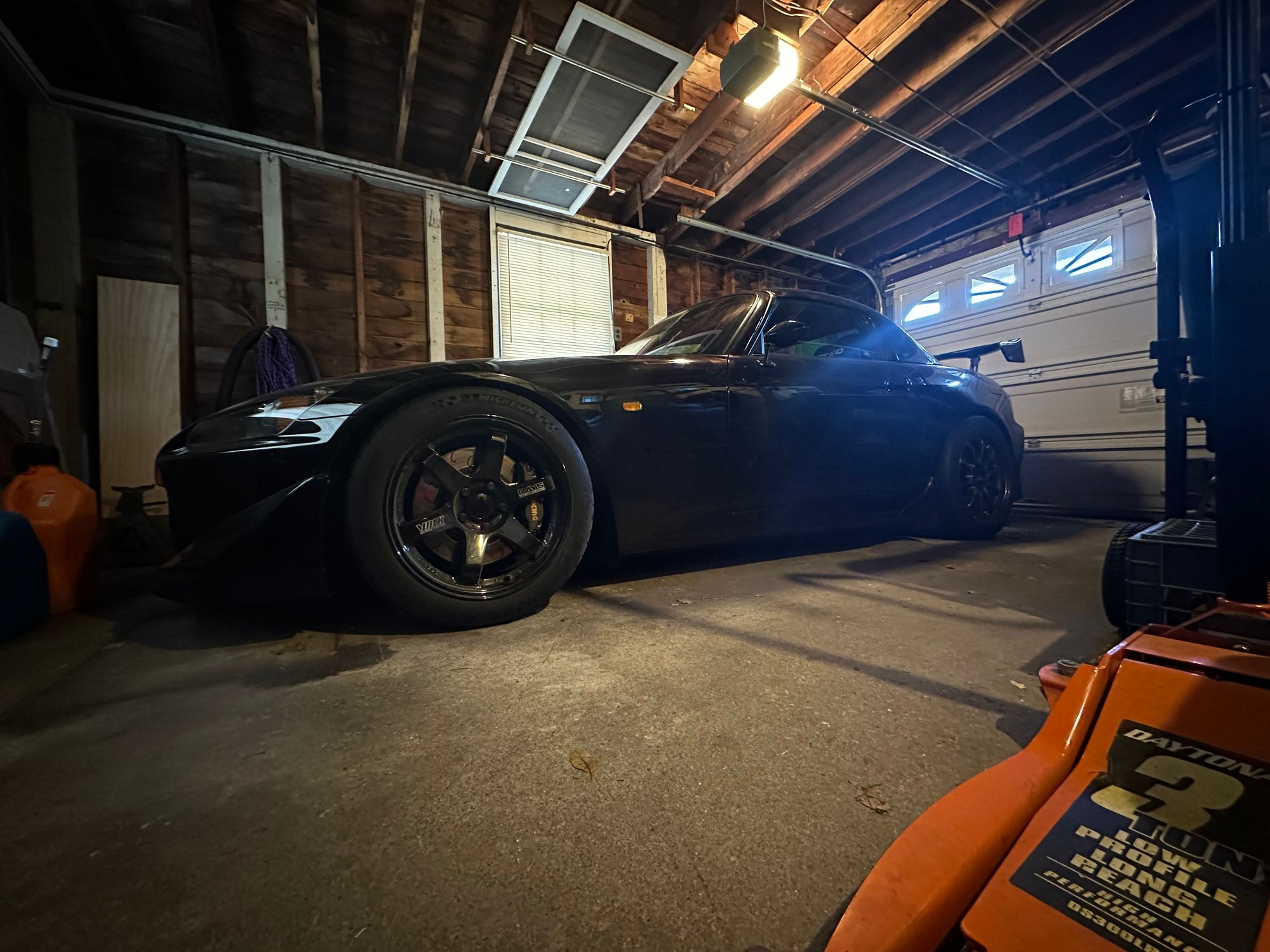

I spent a few years figuring out what wheels I want to go for when I wanted to upgrade to a 255 square setup for my S2000. I considered the TE37, ZE40, TC105N/X, and the Regamaster Evo II, but ultimately went for the CE28s. Was a bit bummed once Evasive Motorsports stopped selling the 17x9.5 +50 CE28Ns when I was trying to get CEs, but Gruppe-S stepped up with their exclusive spec CE28SL which looks really good.
I'm glad I went for the CE28s. They fit the S2000 so, so well.
17x9.5 +46 Volk Racing CE28SL Pressed Graphite, 255/40R17 A052s at the time of the picture, upper control arm offset bushings on the front. Fenders are rolled front, shaved rear.
I have this setup for a year. I never noticed any rubbing on the several track days I take my car to. It did rub during full-lock steering in parking lot type maneuvers, but that's the only time I noticed rubbing and it's on the inner fender.
