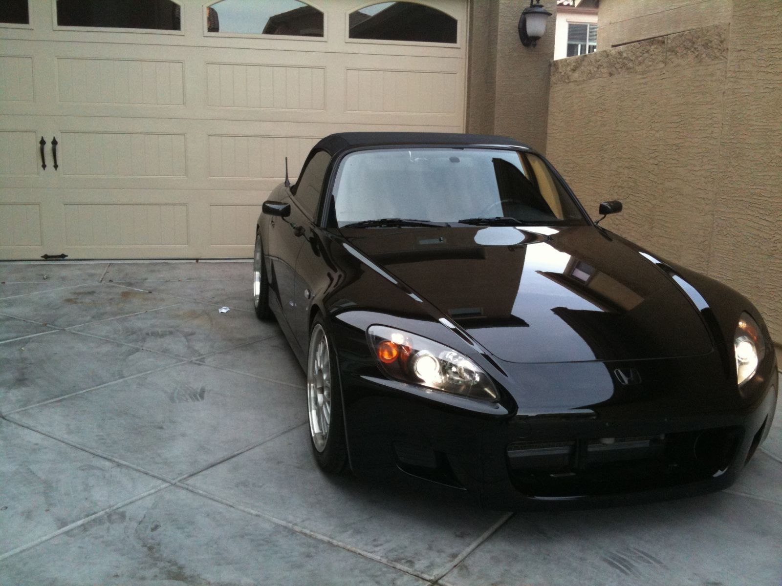

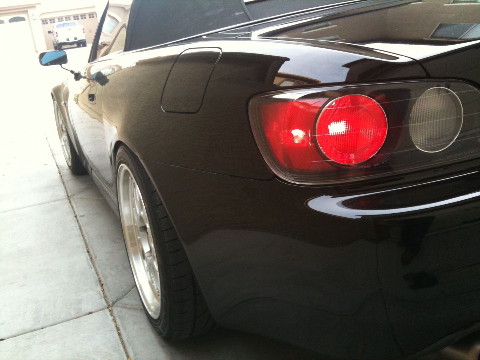

Old May 13, 2010 | 03:13 PM
  #679
mrandyk's Avatar
Joined: Jan 2006
Posts: 298
^nice bro. did you get the lips clearcoated too?
it's a pita to constantly polish the lips once they're refinished like that.
polished lips are bling bling yo. love it with the gold and red combo.
the way LMs come machined and clearcoated is the sex.
Old May 13, 2010 | 03:56 PM
  #680
skang's Avatar
Joined: Feb 2008
Posts: 64
From: Santa fe Springs. ca
yes, they were fully polished in and out.
