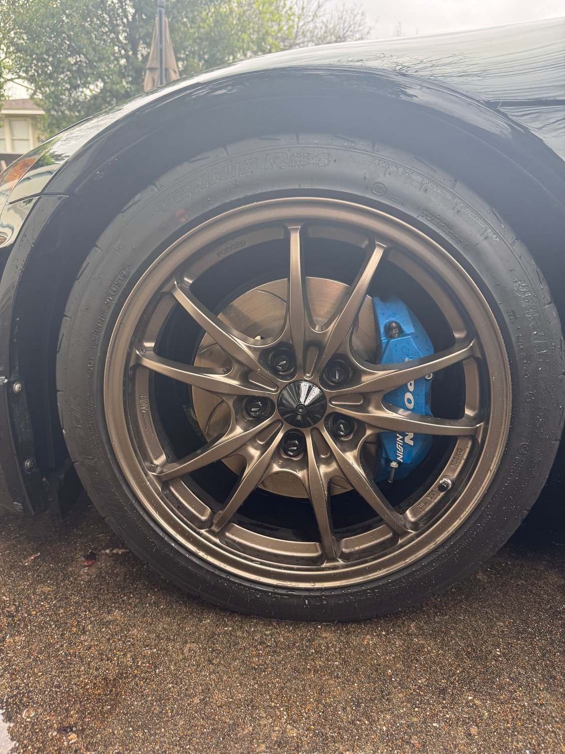

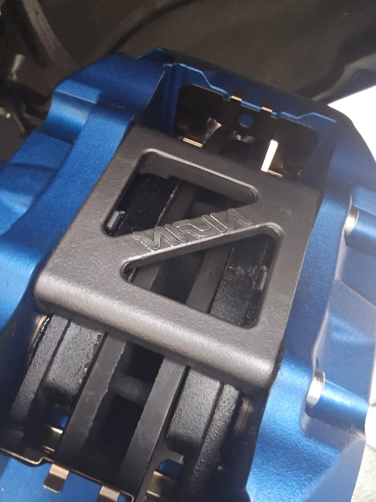

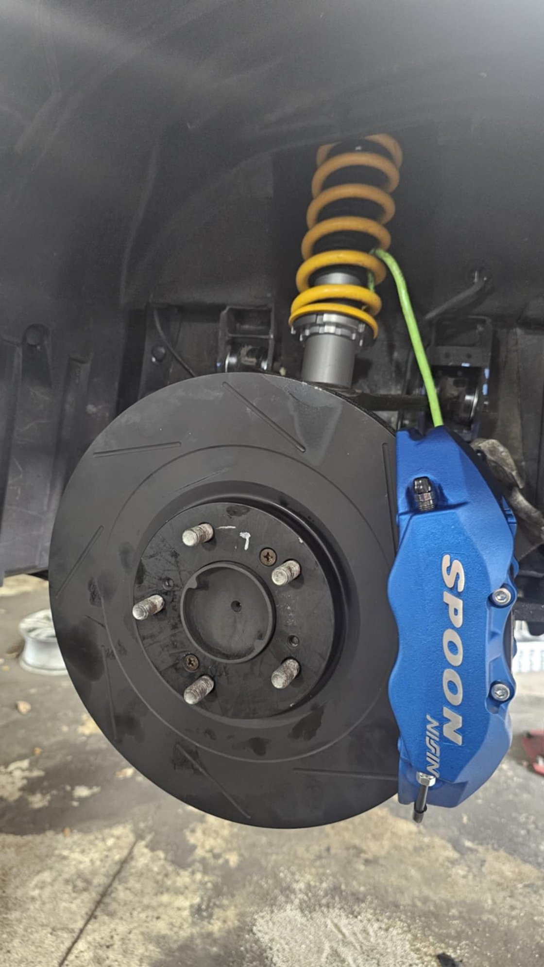

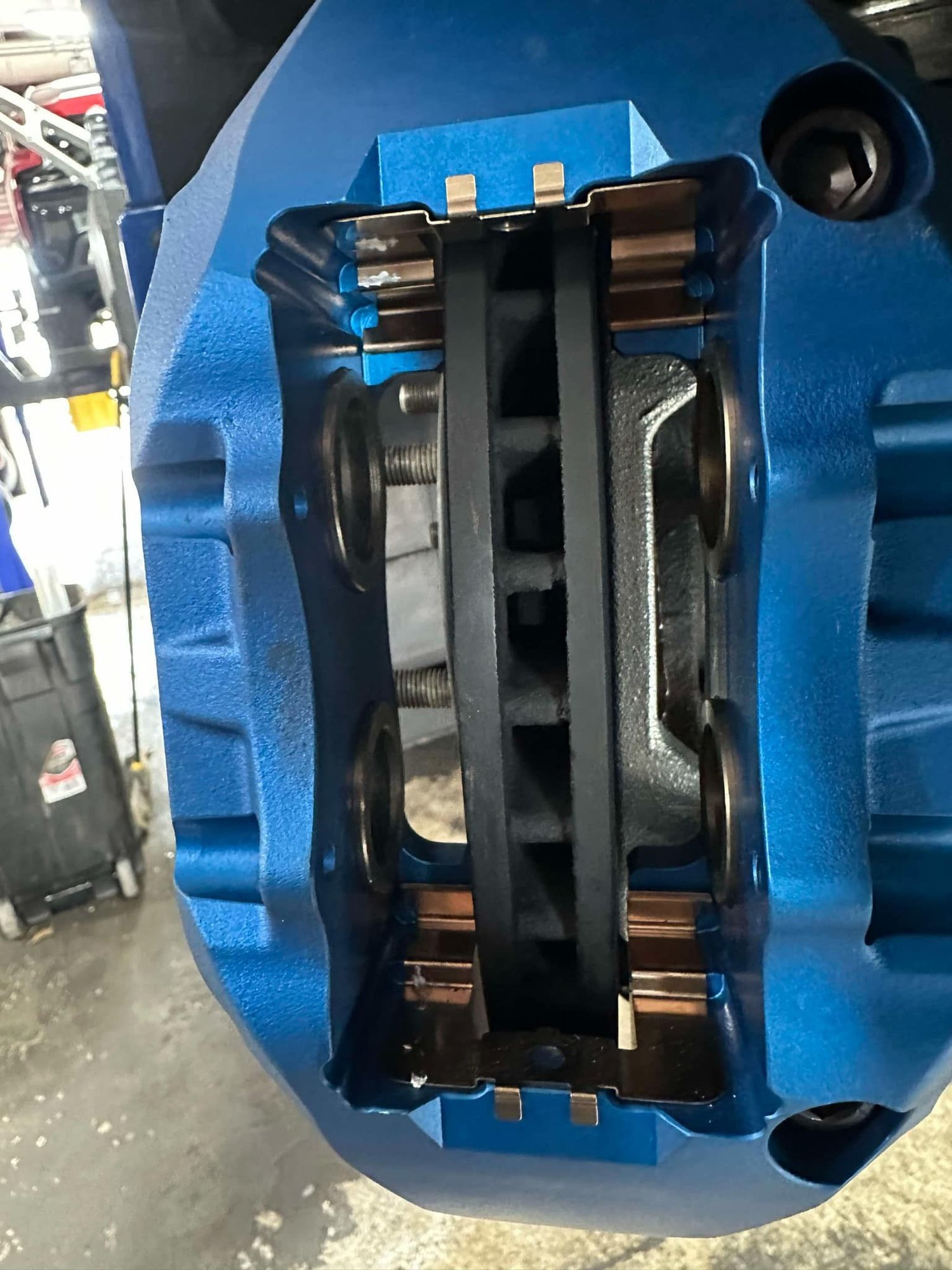

Got my Ballade 330mm rotor x Spoon Caliper installed with Stoptech ST40 brake pads. Pads are now snug perfectly inside the monoblock with no overhang. About to pair it with some TE37 SL 17x9.5 +45
nice! How did you achieve it?
Old Jan 31, 2025 | 08:03 AM
  #264
Distracted S2000's Avatar
Joined: Apr 2009
Posts: 436
Likes: 17
Trim the pad ears so it can seat lower. Takes 2-3 minutes with a hand dremel tool.
I thought about that but I was concerned about the pads floating, you don’t get any pad vertical pad movement at all? I may have to give it a try
I mean street wise and spirited driving no noticeable performance with my very slight 1/8”overhang (I just shave the edge of pad surface so doesn’t squeak on the edge of rotor) but I am kinda ocd and having it flush be nice!
Depends on how much material you take off. It's better to grind away slowly rather than rushing to cut a huge chunk off. You can always remove some, but you can't add it back (unless you have a welder to tack weld). Mine is pretty solid, and I also added high temp brake grease on them as an added precaution. Brake pads are disposable, calipers are not. It's better to trim pads than to cut the calipers.

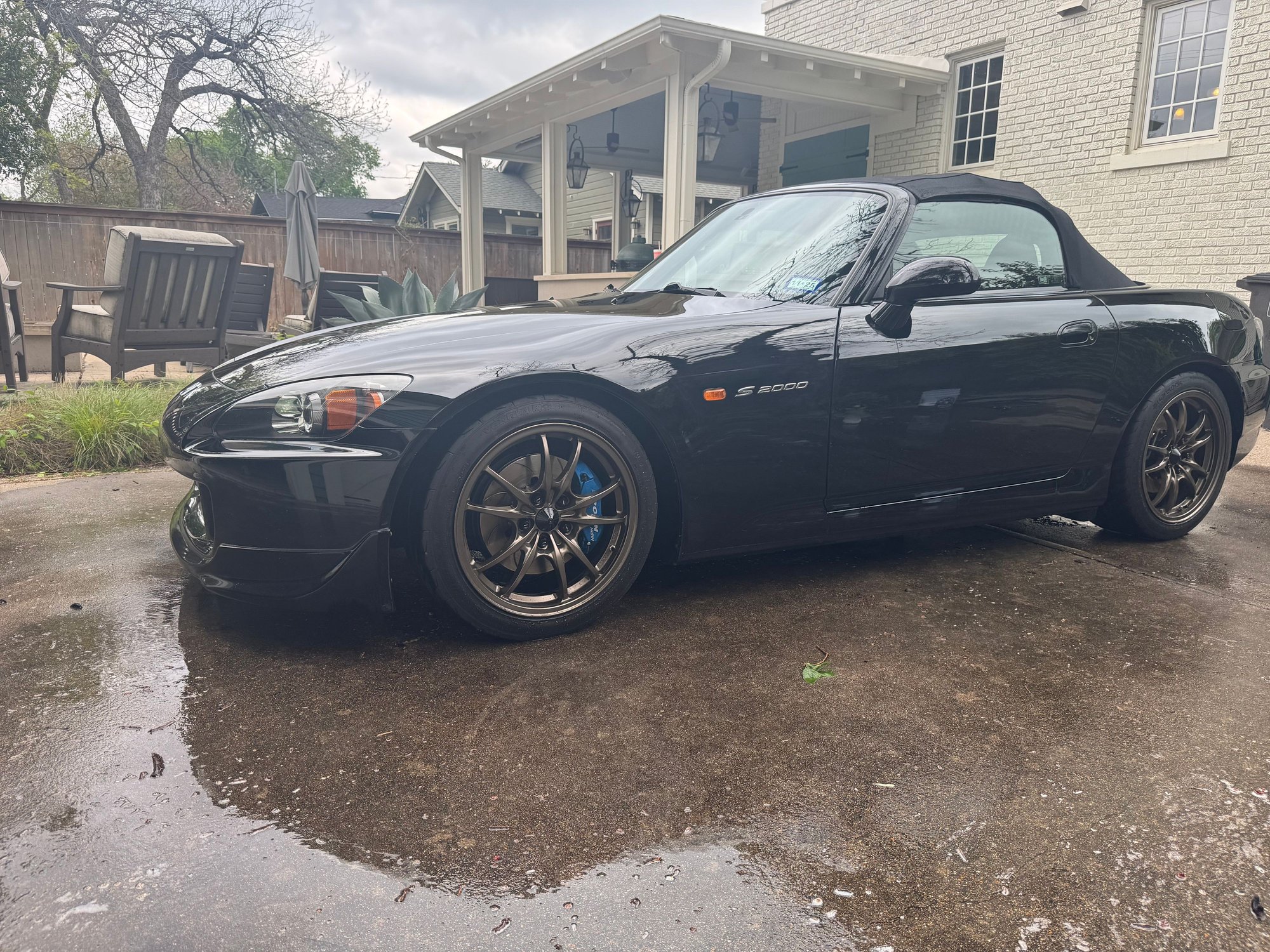

Spoon calipers on Girodisc rotors, under MITA MS-10s (17x8 +53). Plenty of clearance.
