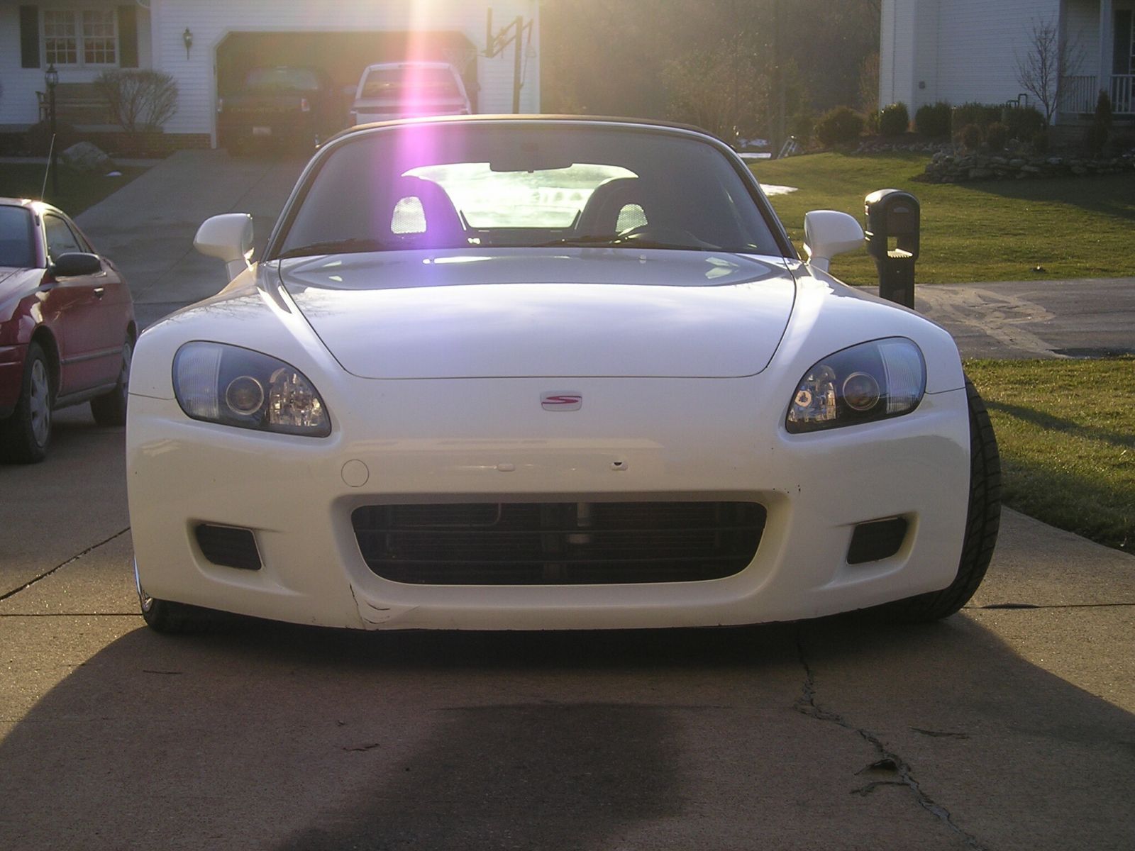

I think w1ngman is definitely the one that's done this the most. i think some of the local people have done it themselves..
david, tim, etc... have done it
here is a pic of mikes2k's ...courtesy of w1ngman
(hope he doesn't mind me posting this pic )

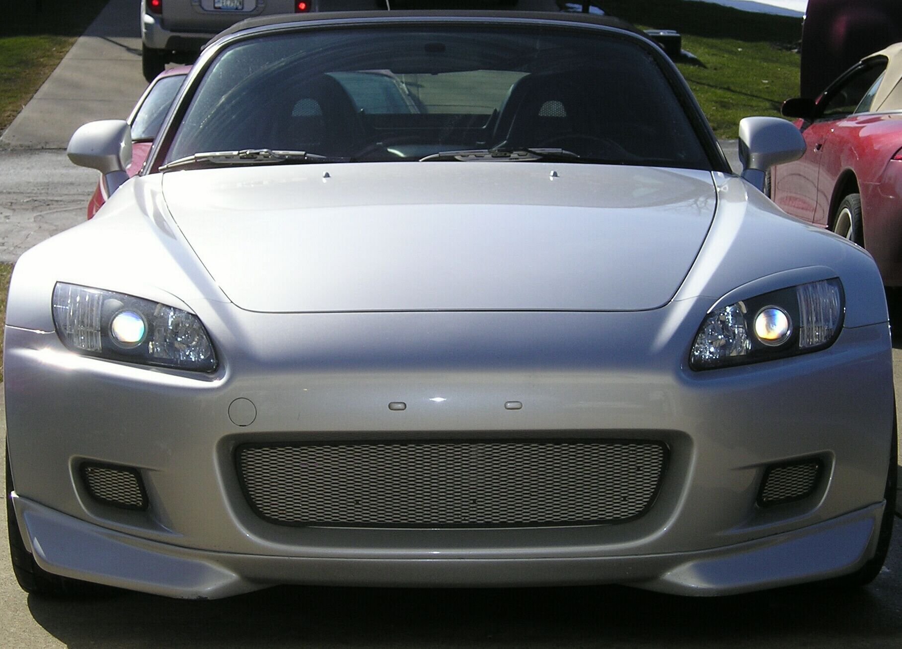

Here are some pics of the process for you.
My happy spa

Hey Scott, what was the point of painting those bulbs silver? Thanks J
Old Sep 2, 2004 | 10:17 AM
ROGUE3308's Avatar
Posts: 8,361
From: Huntington, WV
You took my question J ! What gives with the painting of the bulbs Scott?
