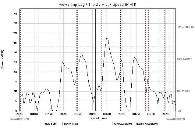

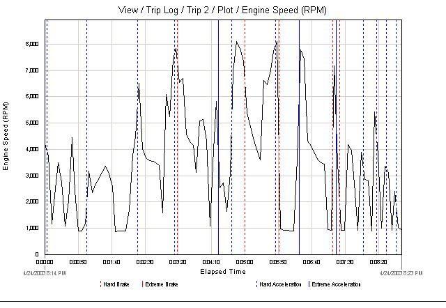

Well, I just got my CarChip E/X in today and did a quick test of it as promised. I'm pretty happy with what it can do so far but I still have a lot to figure out about it. I did a quick 6.2 mile run to see what kind of data output the software would give me. Here are the results:
REPORT VIEW
View / Trip Log / Record Trip 2
Vehicle : S2000
CarChip : Marcus's CarChip E/X
Start Time : 4/24/2003 8:14 PM
End Time : 4/24/2003 8:23 PM
Duration : 0:09:00
Idle : 0:00:25
0 to 60 MPH : 0:05:53
60 to 100 MPH : 0:02:31
100 to 158 MPH : 0:00:10
Over 158 MPH : 0:00:00
Distance : 6.2 Miles
Average Speed : 41 MPH
Maximum Speed : 119 MPH
Hard Brakes : 5 (Between 0.28 G and 0.48 G)
Extreme Brakes : 0 (Over 0.48 G)
Hard Accelerations : 10 (Between 0.28 G and 0.48 G)
Extreme Accelerations : 3 (Over 0.48 G)
Parameters
Parameter 1 : Vehicle Speed Every 5 Seconds
Parameter 2 : Engine Speed Every 5 Seconds
Parameter 3 : Throttle Position Every 5 Seconds
Parameter 4 : Coolant Temperature Every 5 Seconds
Parameter 5 : Fuel System Status Every 5 Seconds
Comments :
PLOT VIEW

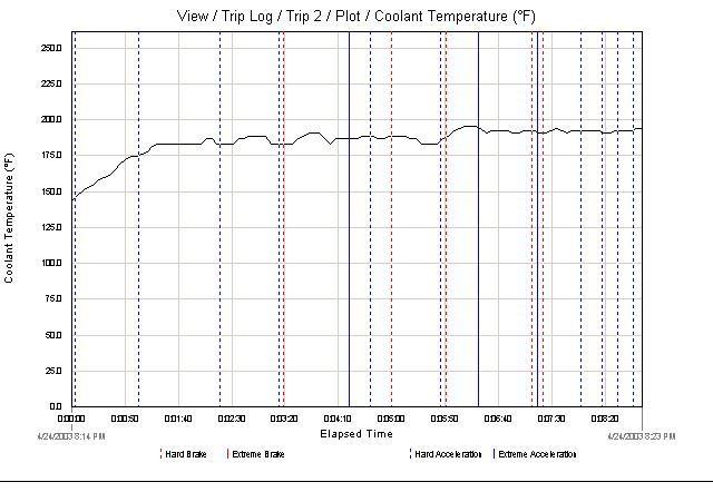

In the software you are able to zoom into the graphs to get a more detailed view.
There is also a table view that will break down every reading by the polling interval you select, I chose 5 seconds, I'd show the table but it's huge even from my short trip.

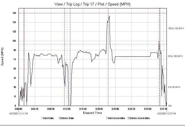

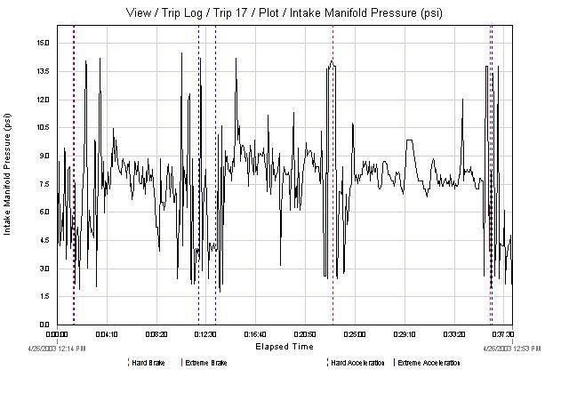

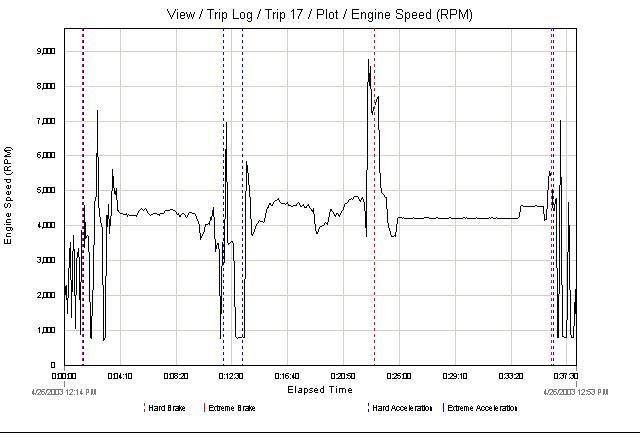

This latest data was from my drive up to Spokane where I was in the accident. This data was my 46.5 mile run from Pasco to Connell where I stopped for fuel:
View / Trip Log / Record Trip 17
Vehicle : S2000
Start Time : 4/26/2003 12:14 PM
End Time : 4/26/2003 12:52 PM
Duration : 0:37:47
Idle : 0:00:34
0 to 60 MPH : 0:05:13
60 to 100 MPH : 0:30:44
100 to 150 MPH : 0:01:14
Over 150 MPH : 0:00:00
Distance : 46.5 Miles
Average Speed : 74 MPH
Maximum Speed : 146 MPH
Hard Brakes : 3 (Between 0.31 G and 0.51 G)
Extreme Brakes : 0 (Over 0.51 G)
Hard Accelerations : 4 (Between 0.31 G and 0.51 G)
Extreme Accelerations : 0 (Over 0.51 G)
Parameters
Parameter 2 : Coolant Temperature Every 5 Seconds
Parameter 3 : Engine Speed Every 5 Seconds
Parameter 4 : Throttle Position Every 5 Seconds
Parameter 5 : Intake Manifold Pressure Every 5 Seconds
Comments :

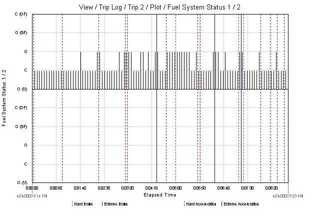

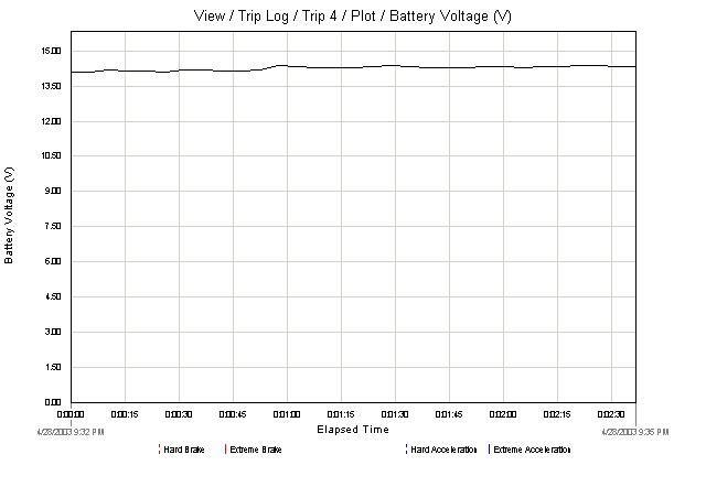

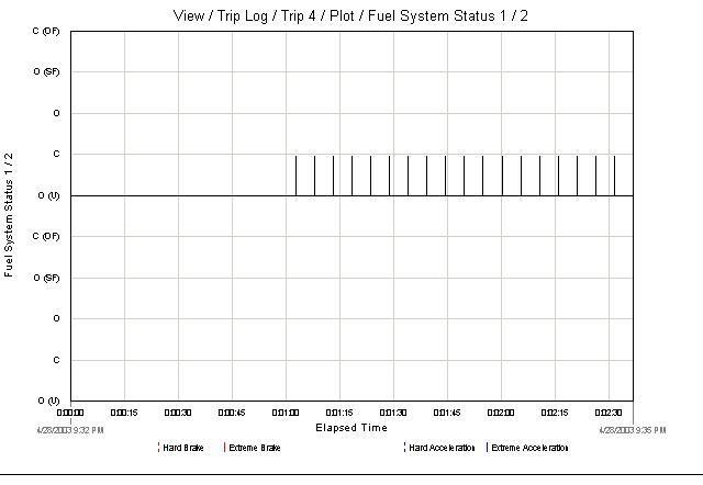

Fuel Pressure and Air Flow Rate are reported by the CarChip E/X as "Not Supported By Vehicle". I can get intake pressure though.
Fuel System Status and Battery Voltage are however:
I am not sure why those two would be unsupported unless Honda did not install sensors to monitor them but I thought the computers reporting would have a set standard by now...
