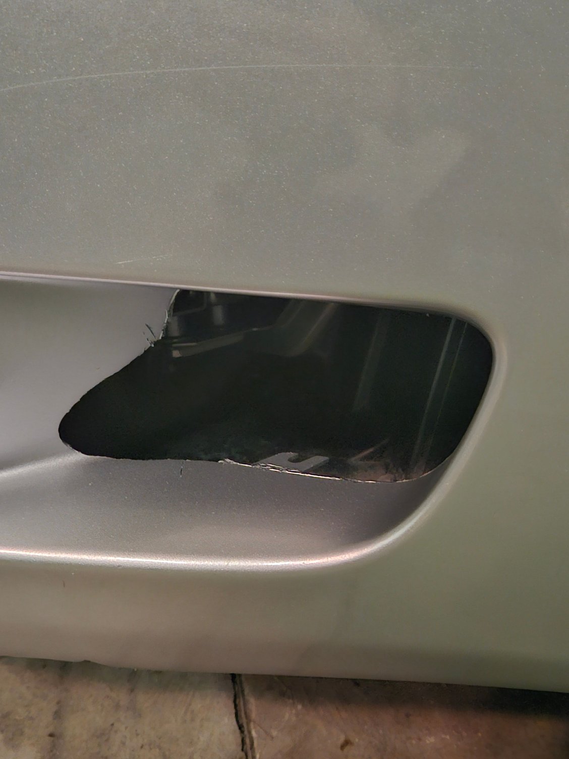

So I recently bought an ap1 and one of the fake air ducts has been cut and mangled up. I'm currently planning on either an asm front or keep oem with the rsg gears front lip. If I end up going with the rsg gears lip will it cover up where the previous owner cut it?

No. The RSG Gears Replica lip will only cover the bottom portion of the formed "duct" and will go up to the cut portion but not cover it.

Probably opened to install an actual duct to cool the brakes or as a cold air intake. Complete new OEM front front bumpers were commonly available to at least a couple years ago so you may find a replacement.
Is there a VIN tag on the bumper (visible with the hood open)? If this is an otherwise 10-VIN car I'd consider repairing the damage although I've no clue how it could be done. Obviously need to mask the VIN tag before the repaint.

A big lip like the J’s Racing lip would cover up that cut. Not many others would.
