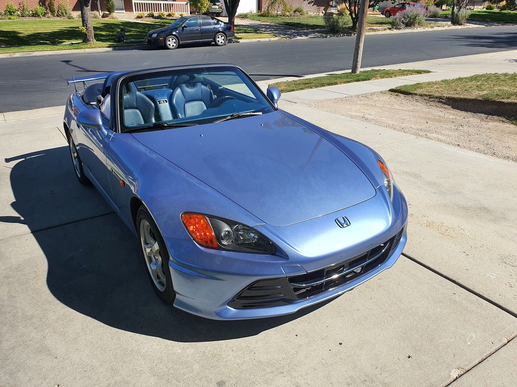

pulled the bumper cover today to install the H, and to drill those holes and get everything installed correctly. While I was at it, pulled the fender liners off enough to finally change the front bulbs so I'm 100% LED now (besides the headlights ofc).
Fender liners are super hammered as are both front strakes so I'll be replacing them for sure sooner than later but for now at least everything is installed correctly - huge thanks again to @MeetThePete for finding that Japanese blog!

looks great! please post a picture from the front if you can

like I said, car needs a wash...
