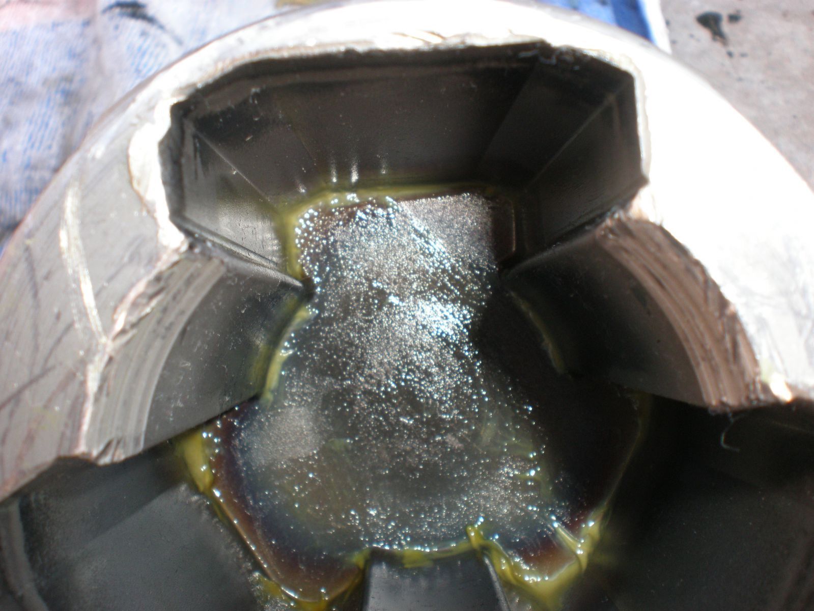

Ok so I spent a good chunk of yesterday pulling my suspension, axle and hub apart.
Having now idea what I was doing. But that's how you learn, by doing.
I was surprised that there didn't seem to be as much damage as first thought.
Maybe some one can tell me different.
Once again I apologize for my terminology (corrections welcome).

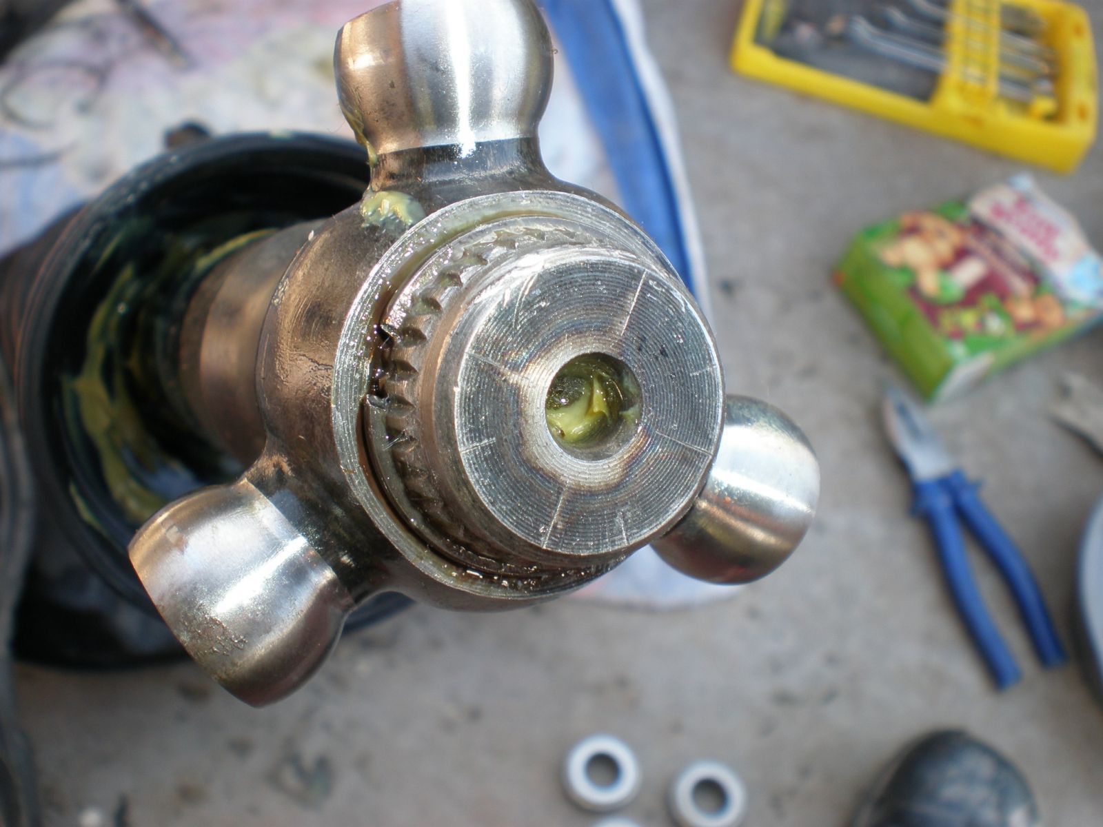

This is the axle boot that connects to the diff, the axle head and bearings.
The boot is scuffed at the top, Is it supposed to be tapered like that?
There are some small scuffs at the top of the axle head, but none on the parts that the bearings sit on.
Bearings apart from being pulled off the axle, seem a1.
The question I'm really asking is, what needs to be replaced?

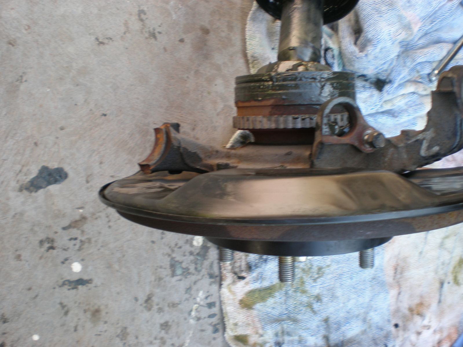

Part 2 concerns the hub, and how the hell you get the nut off? the honda guys I spoke to just said "it's really tight, try harder". I wish I knew this before, now I have to reattach the axle to the diff.
This nut, and do I have to straighten out the dent in it? I know its supposed to be there. And what of the screws? There very tight as well.
The knuckle that attaches to the lower wishbone is the only thing I know for sure is no good. Which is why I'm so keen to remove the hub

Do comparative measurements regarding suspension and such to see if they are ok.
Also, the take out the dent and nut should be able to come off if you use a breaker bar.
If this was my car, I would just replace whatever questionable part....but thats just to save possible headaches.

Replacement is the final plan, but I'm just trying to get her rolling for the moment. So I can get to the body shop
As for the nut, my honda dealer said the same thing. I wish I knew that before, now I have to re-attach the axle to the diff.
