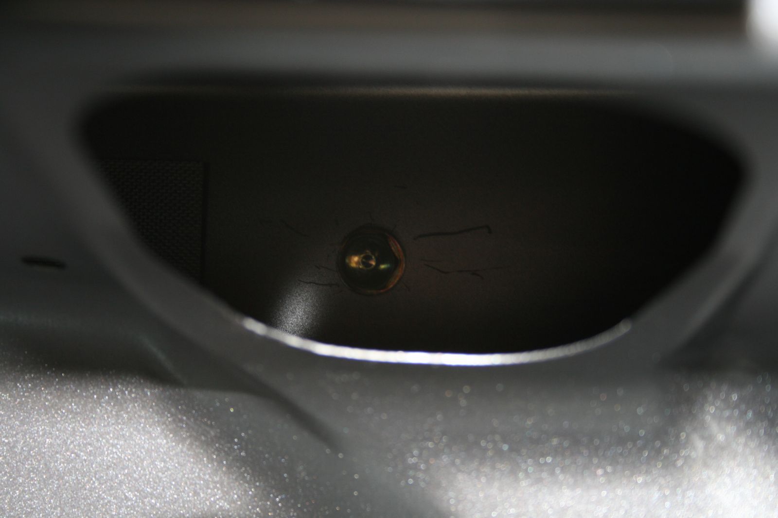

This is about the hardest part, man this hurt.....

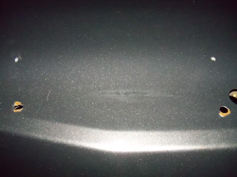

But this one hurt even more. Just be sure you center-punch perfectly. Once you drill the two outer holes, which are based on pre-cast marks inside the trunk, you install the spoiler with the two outboard bolts through the trunk. The inboard holes will have 2 double stick doughnut-shaped stickers attached, which will remain on the trunk lid and show you where to drill. The spoiler has two bolts attached to the underside at the outboard edges, and two nuts affixed within the spoiler for the inboard holes.
With supplied grommets prior to seating the spoiler. Be sure you get good paint coverage on the freshly drilled metal.

Its a tight reach to get the middle two bolts tight.

You did apply touch up paint to the drilled holes? I hope so.

as mentioned above, i REALLY hope you applied touch up paint to drilled holes
too common do I see riced up civics with two lines of rust coming from the spoiler holes
