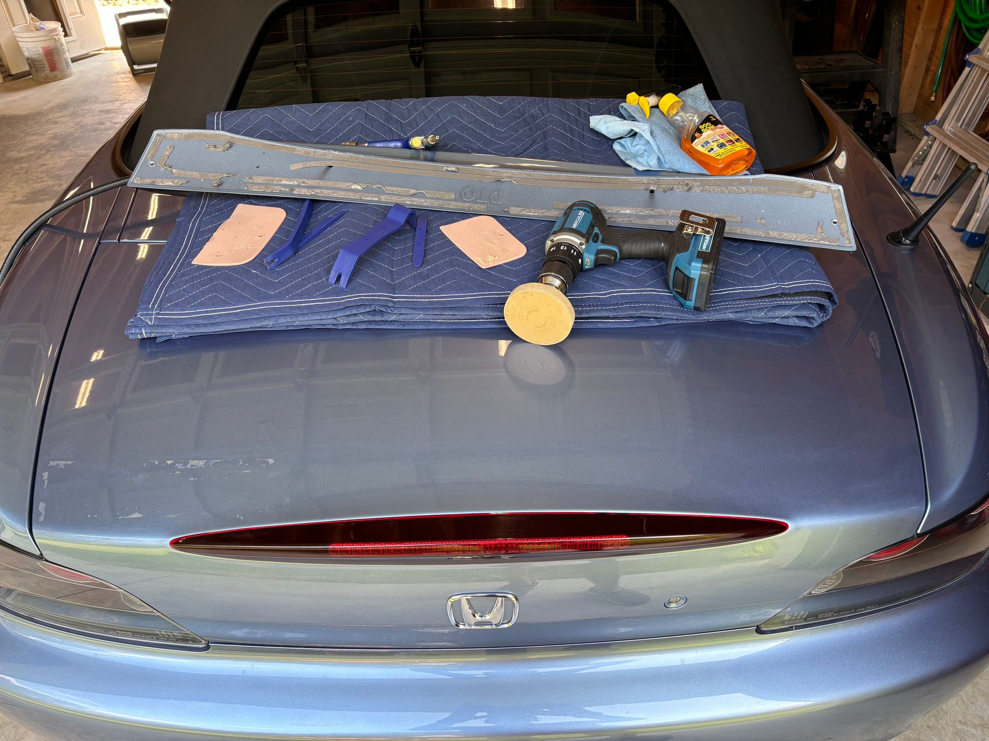

OEM lip spoiler before starting the process
1. Didn’t get any pictures during the process but start with the bondo squeegees and force one under one end of the OEM lip and begin to work it back and forth to break the seal of the 3M tape that is holding the lip onto the trunk. It takes quite a bit of force and patience in slowly working it back and forth to get it further and further under the lip. As you work it under the lip, use the plastic trim tools (won’t scratch paint) and stick the tip of one of the tools under the lip to create upward pressure and hold it off the surface of the trunk. Keep working the squeegee further and further while moving the trim tools and using multiple of the trim tools to add pressure on both front and back of the spoiler. You’ll work your way all the way across the trunk. It gets easier as you go and it will eventually pop all the way off. It is normal for it to leave quite a bit of the 3M tape on the trunk.

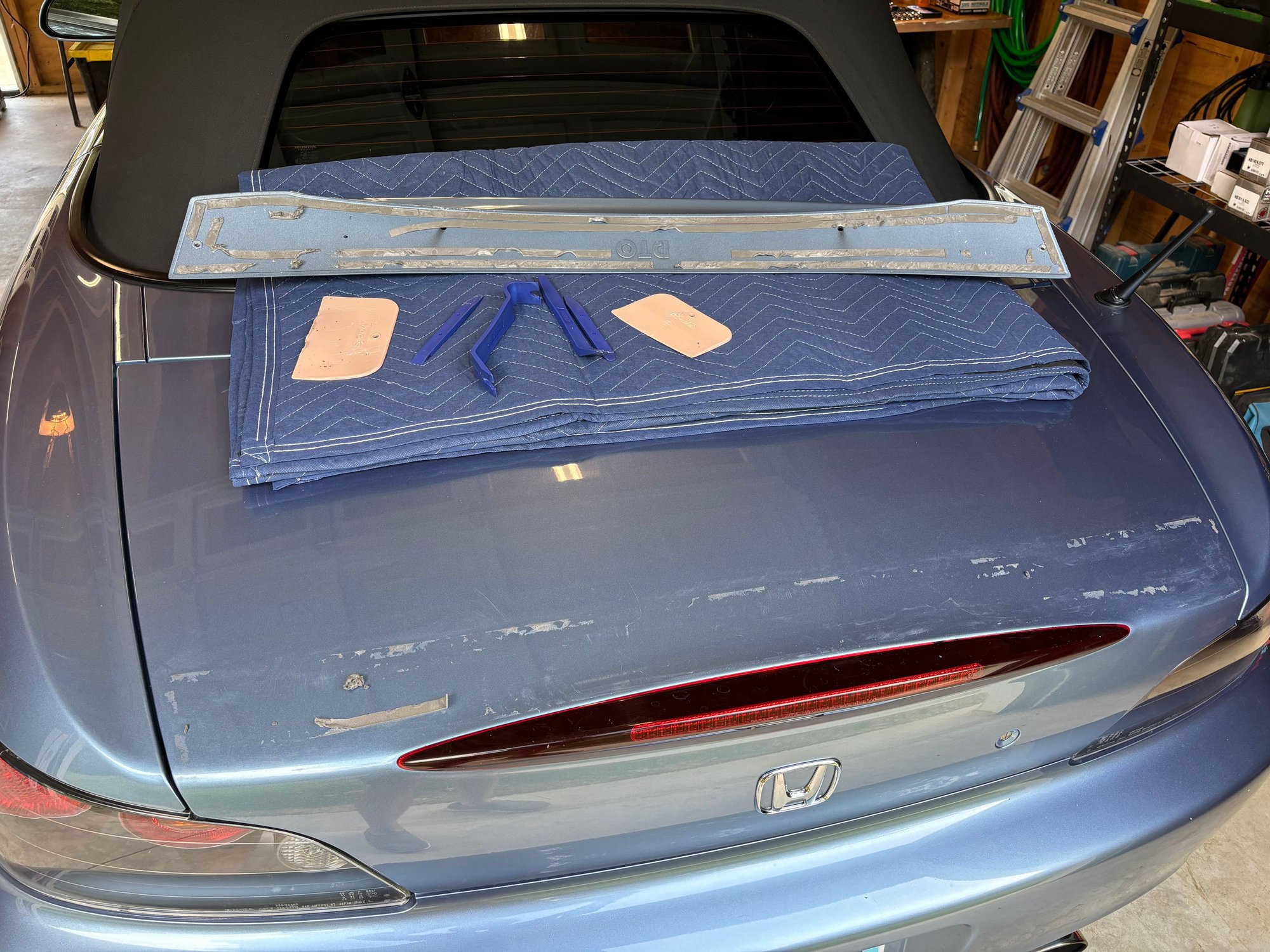

Spoiler removed and 3M tape and residue on car
2. Use a drill and the eraser wheel to remove the tape and residue. You can use the plastic trim tools to try and scrape off the large pieces of tape first. Do NOT put the drill on full speed. Keep a lower speed (half trigger pull) and apply some pressure to the trunk. Take frequent breaks so as not to build up too much heat in the wheel. It will remove all the residue from the car. Don’t worry about the lint and haze it leaves. That will come off as you begin to clean further. Again, takes a little time and patience.

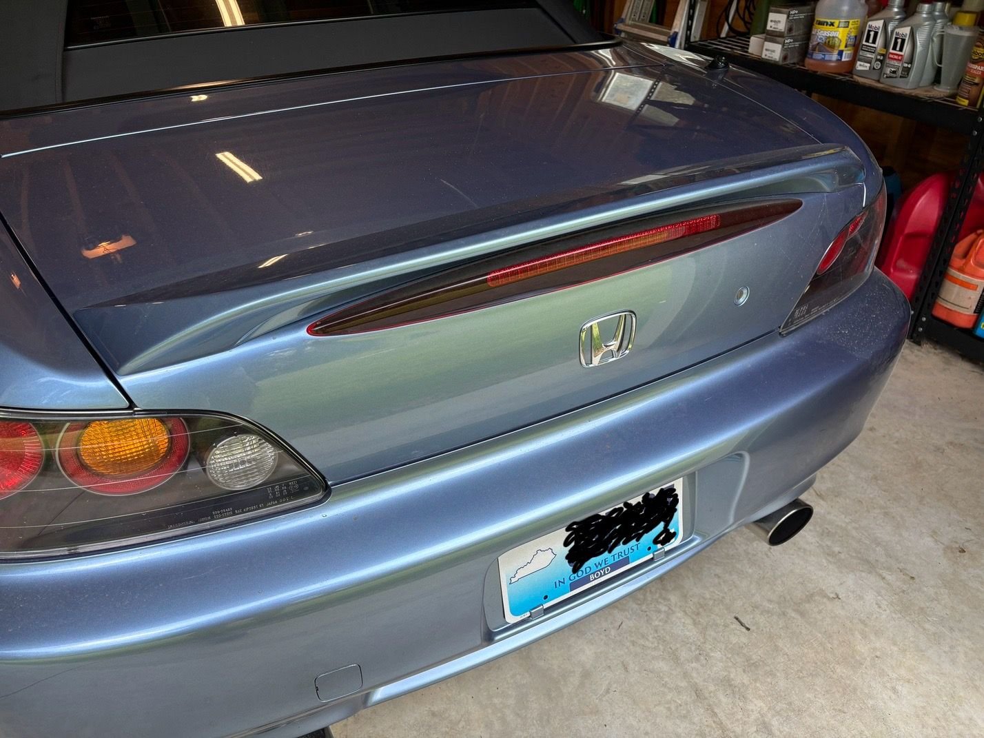

4. Once cleaned and dry, use a cleaner wax and an applicator pad to apply a layer of wax. Let it haze for a couple of minutes and then wipe off with a clean microfiber cloth. The surface should shine like new, with the wax removing any small surface blemishes left behind from the spoiler. The picture below was prior to applying the wax and you can see how good it already looked. After the wax, I couldn’t even tell the spoiler had been there.
Cleaned and ready for cleaner wax as last step

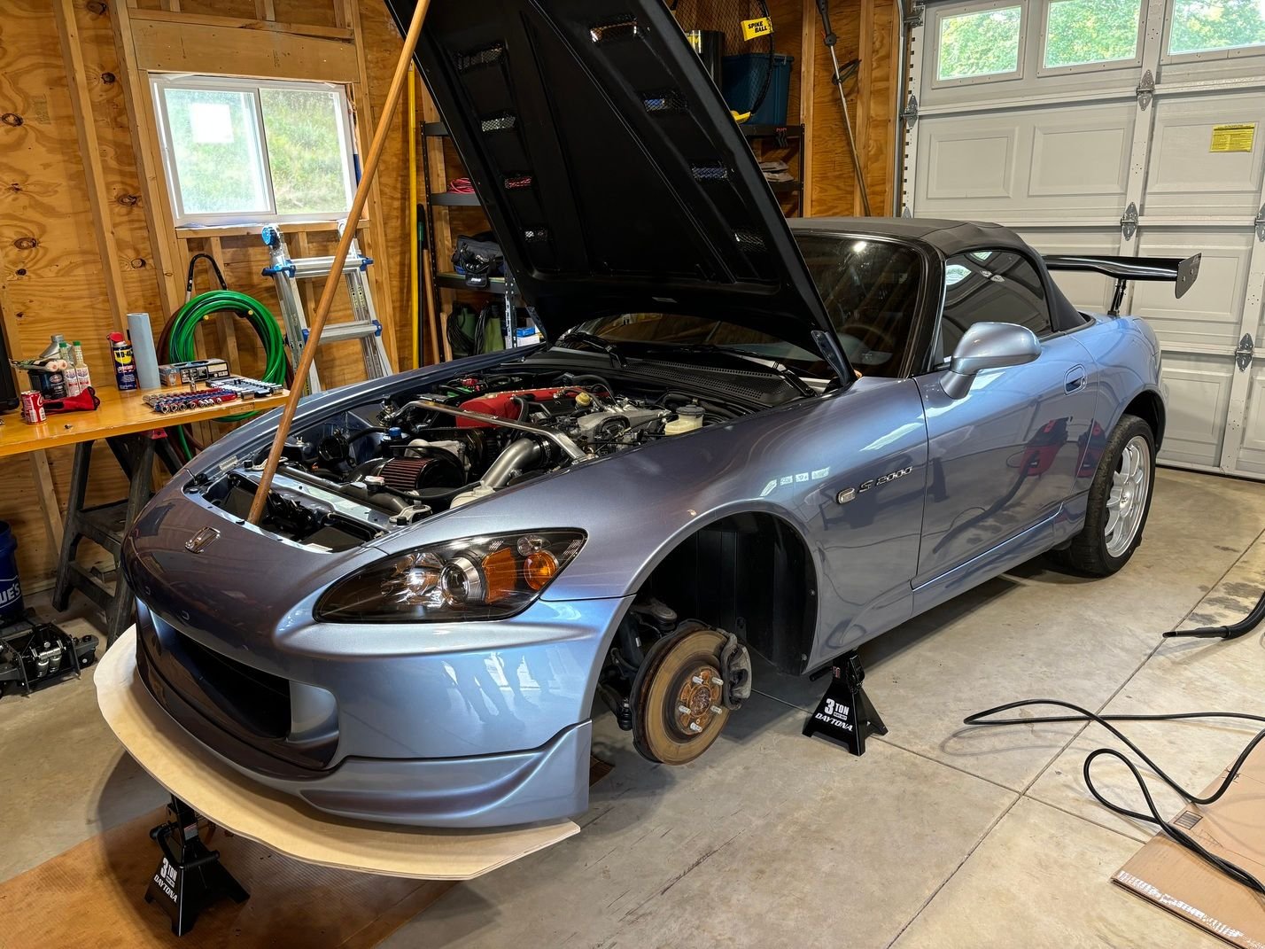

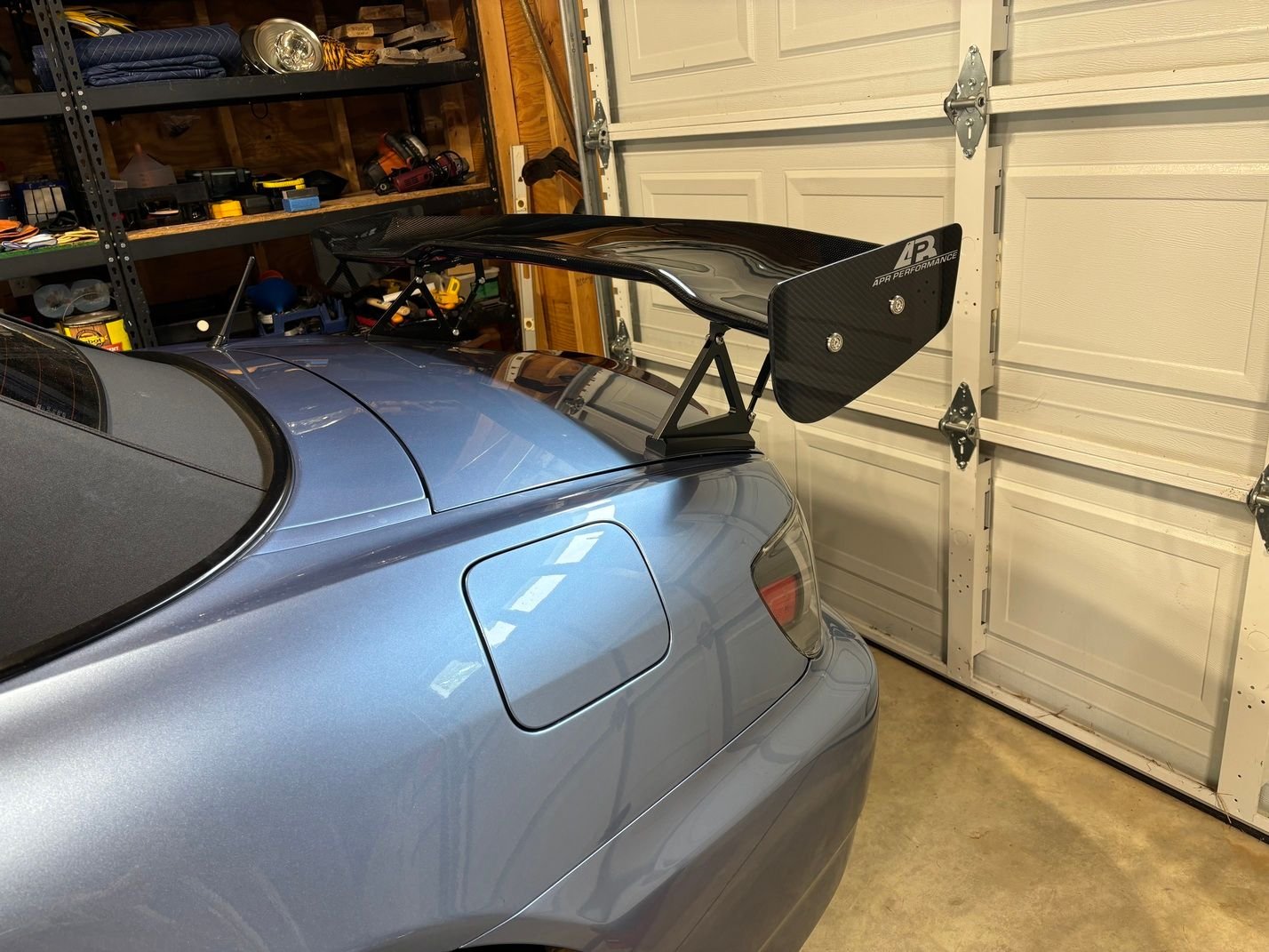

Got the APR mounted! Working on building and custom mounting a splitter around my intercooler piping. Can’t wait to get this all wrapped up and try it out.
Mounted super easy. One of the drill holes was pre-marked on the underside of the factory trunk lid so easy to drill the first hole and then line everything up. Super sturdy and excellent quality.
Work in progress! Getting a custom splitter built from 1/2” birch and trying to get it mounted frame mounted around my intercooler piping (DevSport won’t work). Getting close.

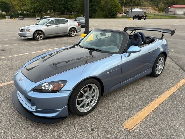

Had to get one more pic posted with the splitter mounted and out in the wild. Loving the new look.
