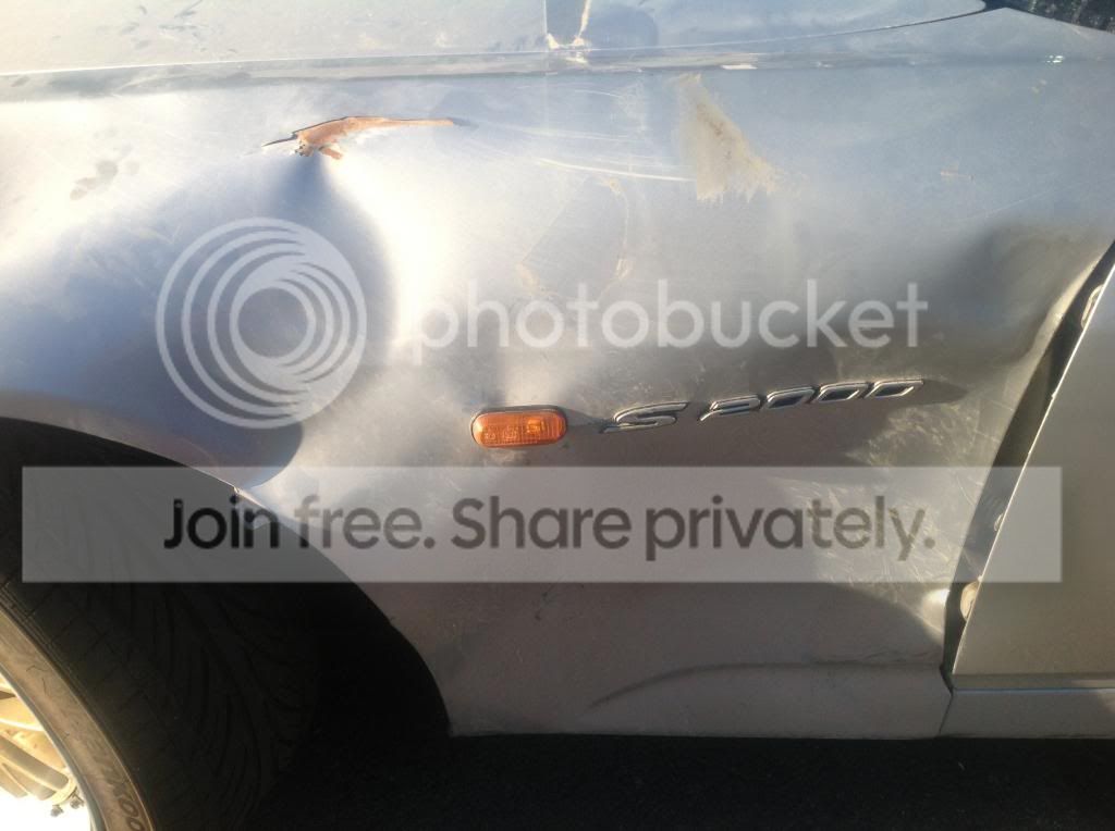

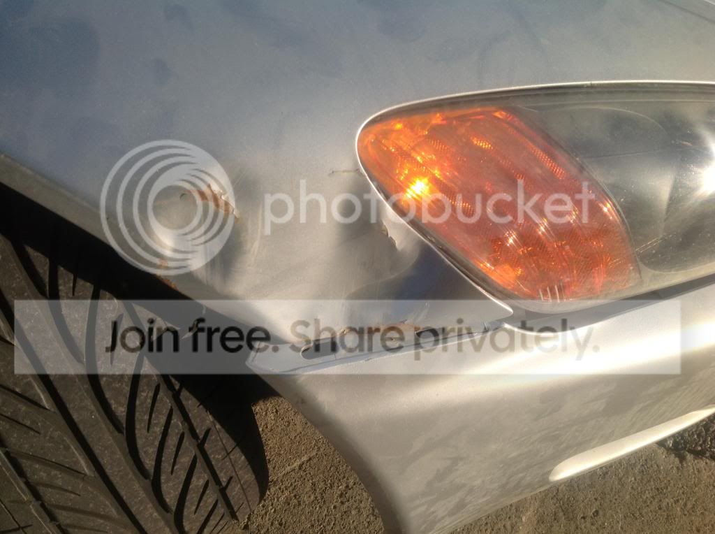

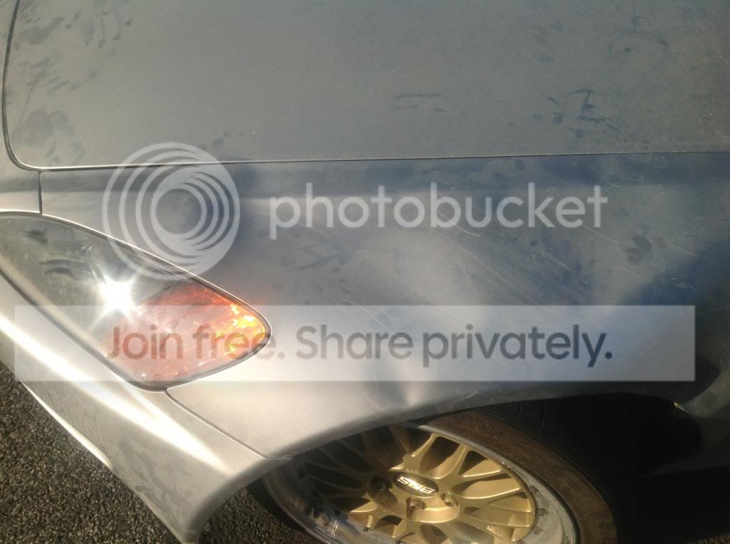

I recently purchased an 03 S2K at auction, had some body damage to the drivers side front fender and door and passenger side rear quarter panel. I have purchased a replacement door, got the old door off and mounted the new door on, but now im stuck.
Issue 1: How do i remove the key lock mechanism from my old door and install it into the new one? I have found the thread ayelein created and the pages from the manual posted by 3ngin33r1 but was wondering if anyone had some tips to make it a bit easier.
