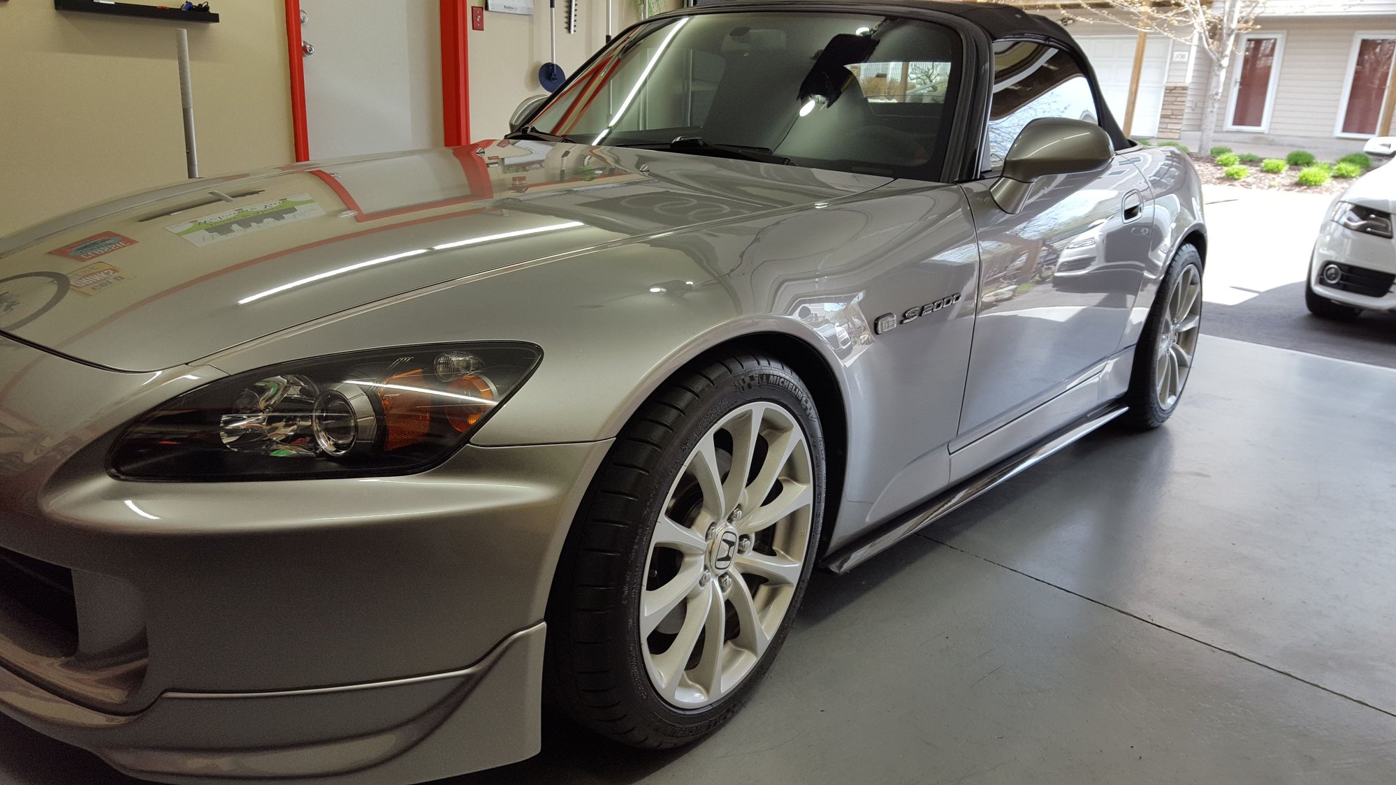

Hey man
You bought the front lip from me.
It was a perfect color match on my Silverstone. Here's a pic.
I'm thinking your front bumper was painted if you have a way off match. Do you have pics?

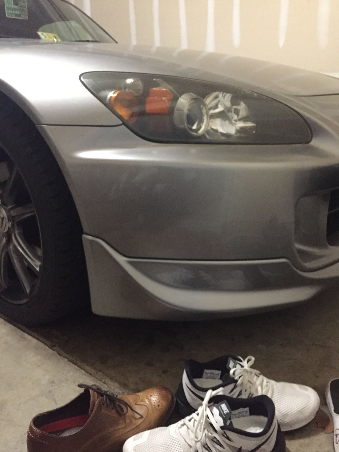

Old Oct 17, 2017 | 07:41 PM
Nibreezy's Avatar
Joined: Apr 2017
Posts: 239
Likes: 8
It looks fine in this picture but ill send a picture of it in daylight tomorrow and you’ll see the difference.

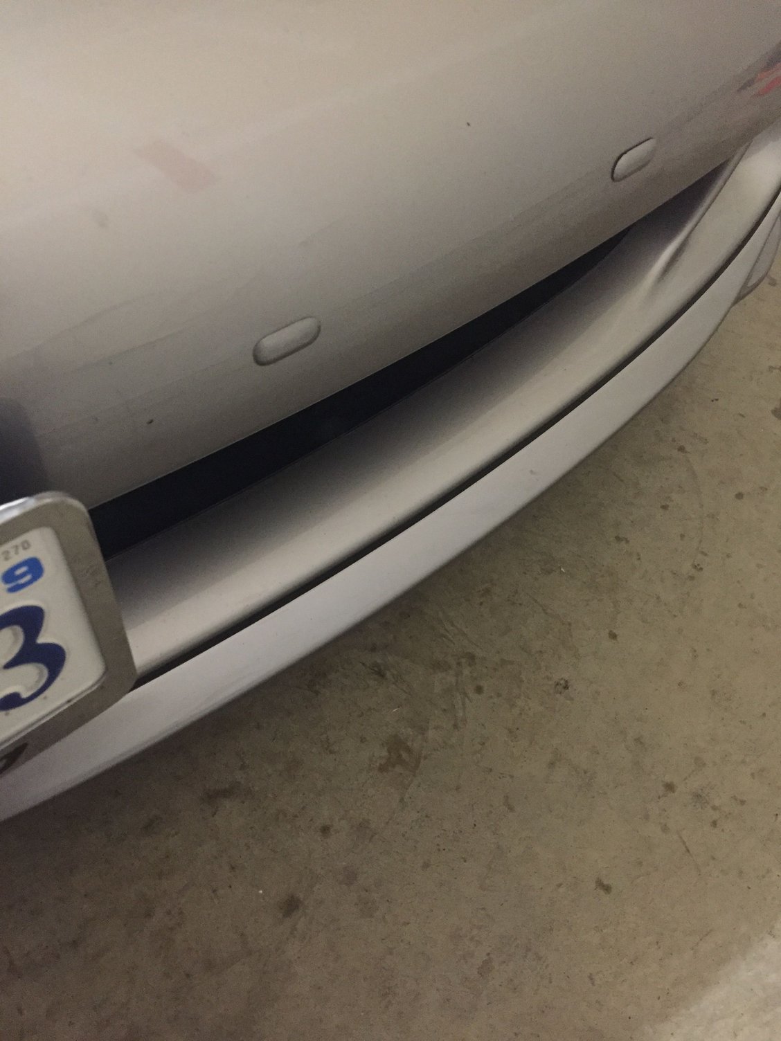

Old Oct 17, 2017 | 07:47 PM
Nibreezy's Avatar
Joined: Apr 2017
Posts: 239
Likes: 8
You can ever so slightly make out a minuscule of a difference in this picture.
Old Oct 18, 2017 | 04:43 AM
MrFunk's Avatar
Joined: Nov 2016
Posts: 1,097
Likes: 130
It's not as bad as I was expecting. From the pics it looks pretty close in color. You will never have a 100% identical match obviously. Unless you re-paint the entire car along with the lip you won't have 100% match. It looks pretty good to me from what you've shown in the pics...
