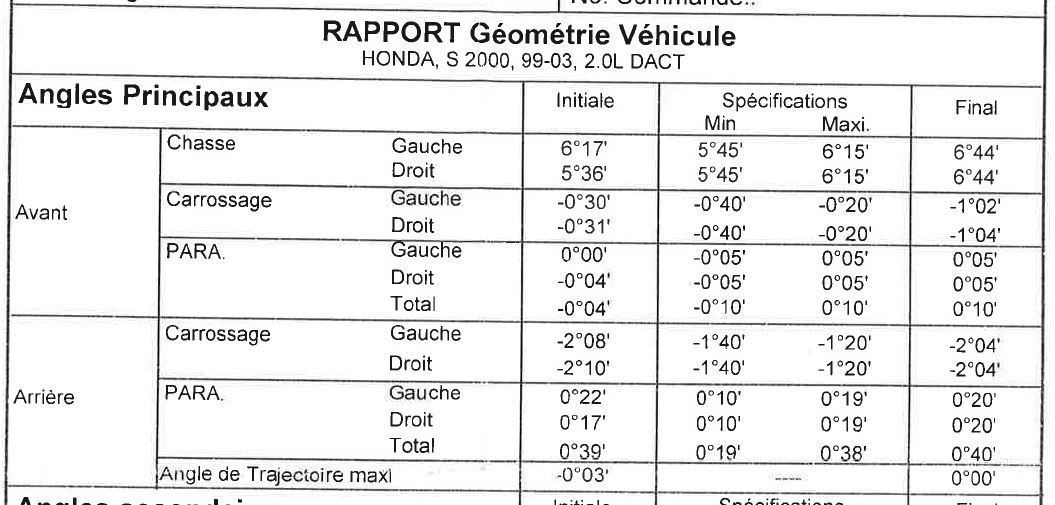

Try 0.2 degrees total rear toe in.
IF street car, maybe -2 to -2.5 degrees camber all around. Caster is a personal-preference thing, I prefer to run at the low end of 5.5-6 degrees. Some will insist that "more is better" though. You might run middle of spec for that or experiment and see what you like there.
After all this if you still find the car tramlines/grabs inconsonant road surfaces pulling you left or right, back off on the camber up front to around -1. There is compromises with running a track alignment on the street, and its not just inner tire wear. I find -1 camber up front still gives a good all around performance, with improved handling on street and improved braking is also a benefit with more strait line tire surface on the ground. Rear you can get away with a little more camber without compromise -1.5 -2.

"UK spec" alignment = way too much rear toe-in at 40 arc-minutes or 0.67 degrees (!). IMO that's at *least* 3x too much rear toe, for me it made the car more nervous and WEIRD handling. While also destroying rear tires at a truly ridiculous rate...

Here is my alignment:

Get the Hardrace/Megan rear anti bumpsteer toe arms and go for 0.2 degrees total toe in just like ZDan said.
40 minutes is just way to much, if you go back to the same place aim for 12 minutes instead, that is the same as 0.2 decimal degrees.
