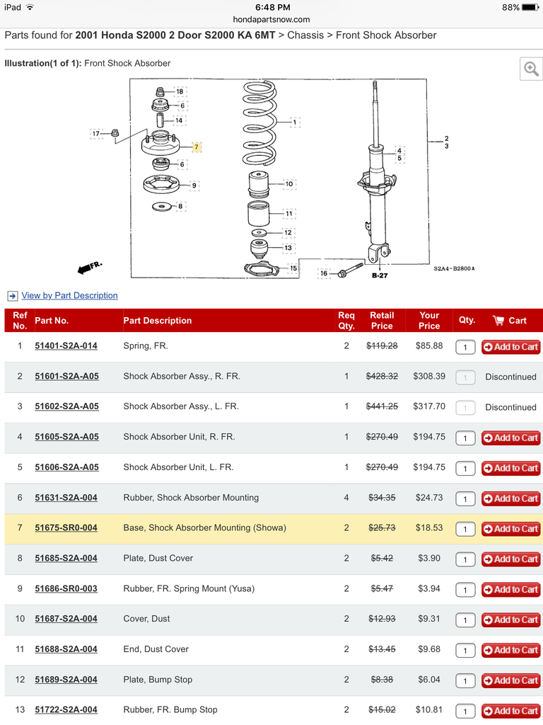

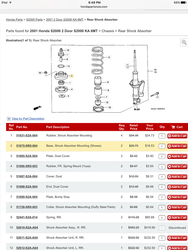

Hey guys I'm looking for some confirmation before installing my KW V3 Coilovers. I'm looking to keep the top hats on my stock suspension and ordering the new ones for the KW. Can anyone confirm all I need to order is #7 for the fronts and #2 for the rears in the diagram?

You'll need 6 (2x) 7(top hat), 14, 8, and 9 in the front. For the rear you'll need 1(2x), 8, 4, and 3 in addition to 2.
You can't beat the oem mounts. They're rubber with a metal plate, the ones for the Integra type R are stiffer, if you're interested.

The S2000 and ITR both use metal reinforced tophat bushings. There's no advantages to the ITR version. FWIW, TL-S's also use reinforced tophat bushings. I'm sure NSX's and other hondas do as well.
you need the whole top end of the OEM tophats. try posting up in the WTB thread. someone usually always has a set to sell
