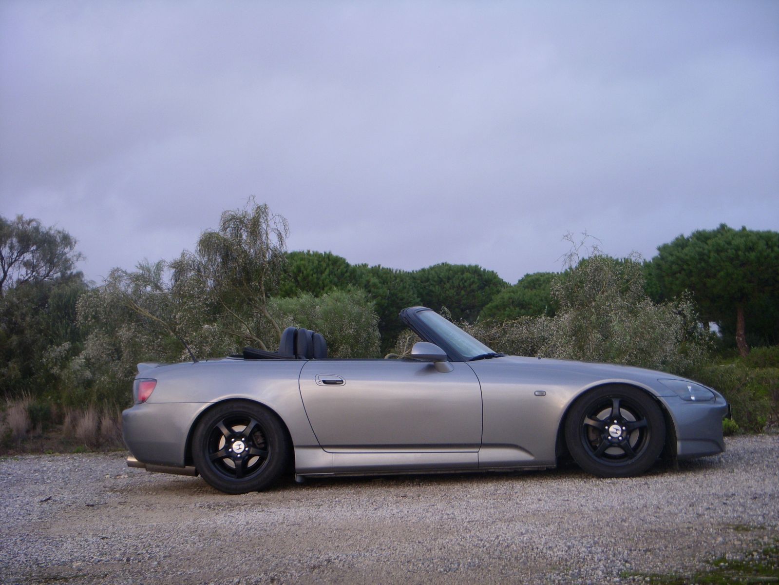

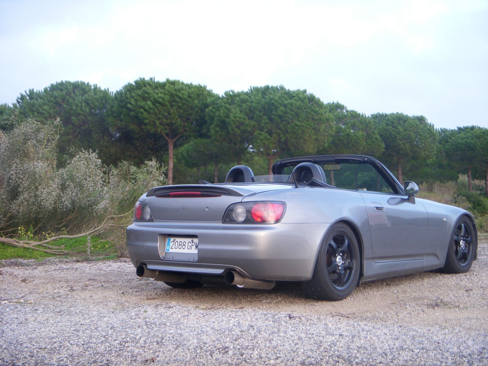

Old Jun 26, 2010 | 03:56 AM
SRap1's Avatar
Joined: Jun 2008
Posts: 578
first one is the neuspeeds with stock shocks, second two are lowered on the second perch of the koni yellows
Old Jun 26, 2010 | 09:05 AM
K.Shift's Avatar
Joined: Sep 2008
Posts: 2,419
From: Canoga Park/ Northridge CA
thanks for all the responses guys..and than ks fearless for takin the time to post that up..thats some good information from a professional.
as for the neuspeeds..ive heard that ap1s end up being dropped more with these springs so thats why i asked if anyone had info.
and thanks SRap1..car looks great. and i have an idea now.
