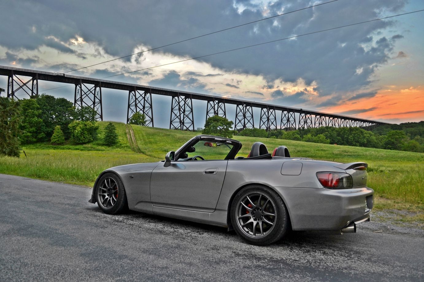

So I'm looking into my suspension options because after a few years on my D2's I'm tired of the rough ride. I'm talking with the guys that run D2 and hoping I can make some changes to get things sorted out but I'm examining my options. One that I've come across is the Koni/GC setup. I had a similar setup on one of my old cars and enjoyed it but I'm wondering if on the s2000 I can achieve the ride height I have currently (see below) with them and still maintain a decent amount of suspension travel. I just worry since you're adjusting the height at the spring and not on the bottom bracket that this is going to be too low for them.
http://www.flickr.com/photos/ouhei/8618386528/
http://www.flickr.com/photos/ouhei/8618386574/

You can make your car really low with that setup!! I had my car super low for a while with them but have since raised it up as I was scraping too much.
Put them on the lower perch and then adjust them down. I'm sure they can go that low or lower even.

Here's one pic. They can go a bit lower than this I am sure but would have scraped too much if I did.
This looks like it might be ever so slightly higher than I am, but very very close! Thanks for the picture.
