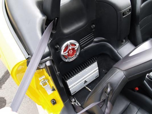

My recommendation for either version of the sub would be the JL 250/1 (same power at 4 ohm and 2 ohm) mounted on teh wall behind the passenger seat. You will give up about 1" of seat travel/leg room.
This is a JL 500/1 - 250/1 would be a little bit smaller, but the amps is the same thickness.

That Alpine is a decent sub amp - will run plenty cool.
Unfortunately I do not think it would work behind the seat. The JL Amps have the heat sink on one side (on the top in the provided image) - most all other amps have the heatsinks on both sides.
