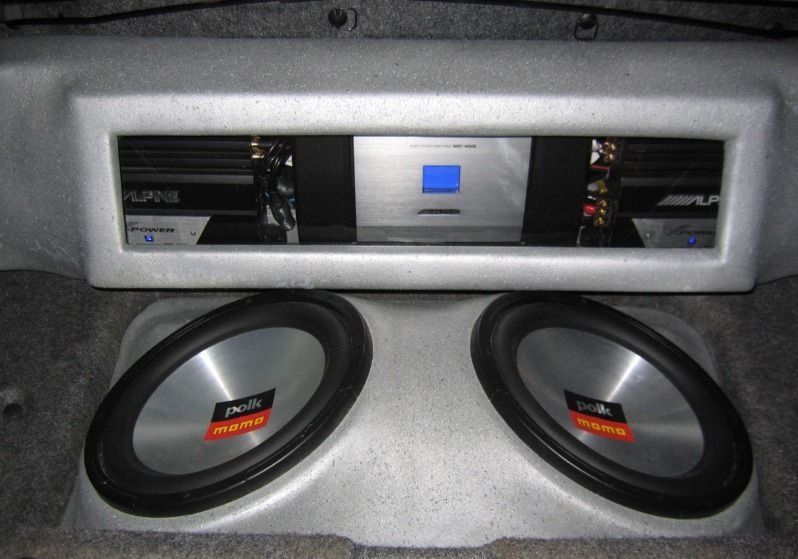

For 2 12's fiberglass is pretty much a requiment. Just for reference the box below is approx. 1.4 ft3. Those are two 10's.

cool, thanks for the info, i was thinking about something like the pic in J_C_A's post, except built up higher and wider, have the subs at an angle facing backwards, and was going to try to use pas2k's flat amp rack

Minimum 1.3 cuft per sub, and a port of 3" x7.75" per sub.
This is assuming he wants a ported enclosure, isnt it? A sealed enclosure he can get away with as little as .75CF / sub (according to www.sounddomain.com). That would mean he could make something similar to j_c_a's enclosure, and not have it stick up / out a lot more.
If he is going to need a true 2.65 ft^3 (for a ported enclosure), that is a little over DOUBLE the tool well size. Unless he wants to glass his entire trunk, that box, if made like j_c_a's would almost stick up to the trunk line (or at least most of the way).
If I were in this situation, personally, I would use 1 of the 12" subs in a sealed tool well enclosure (you can mount it flush this way). Then, if the bass is still not enough, I would port the rear decklid into the cabin.
