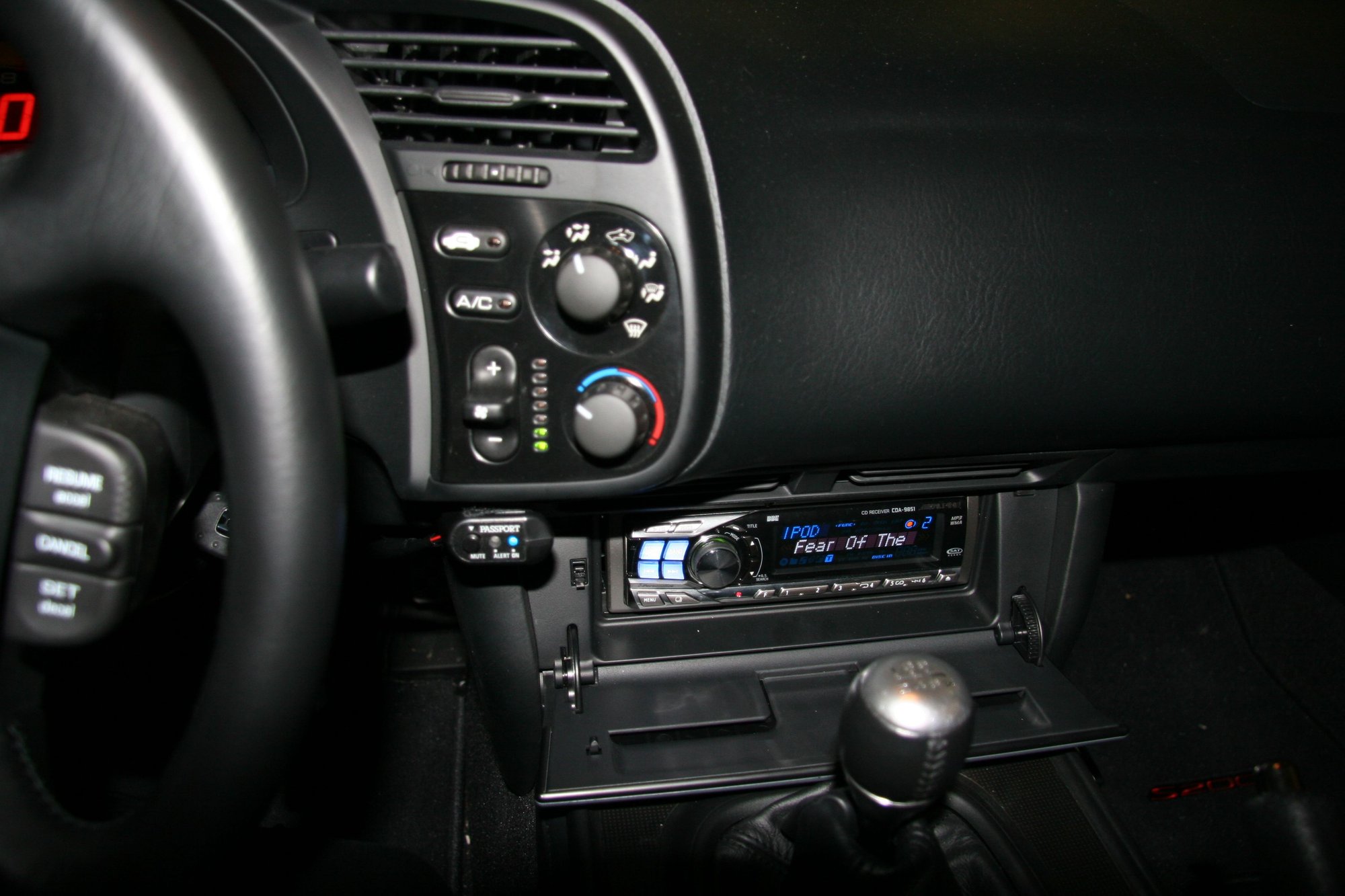

So I don't understand why so many people give up their trunk and spare tire in order to upgrade the stereo. Here's my install which allows me to keep most of the trunk and still have great sound! Installed by Z Auto Sound in San Jose.
Amp: Alpine MRV-F545
Speakers: Morel Dotech MKII
Sub: Elemental Designs 10" 11Ov.2
Head Unit: Alpine 9851

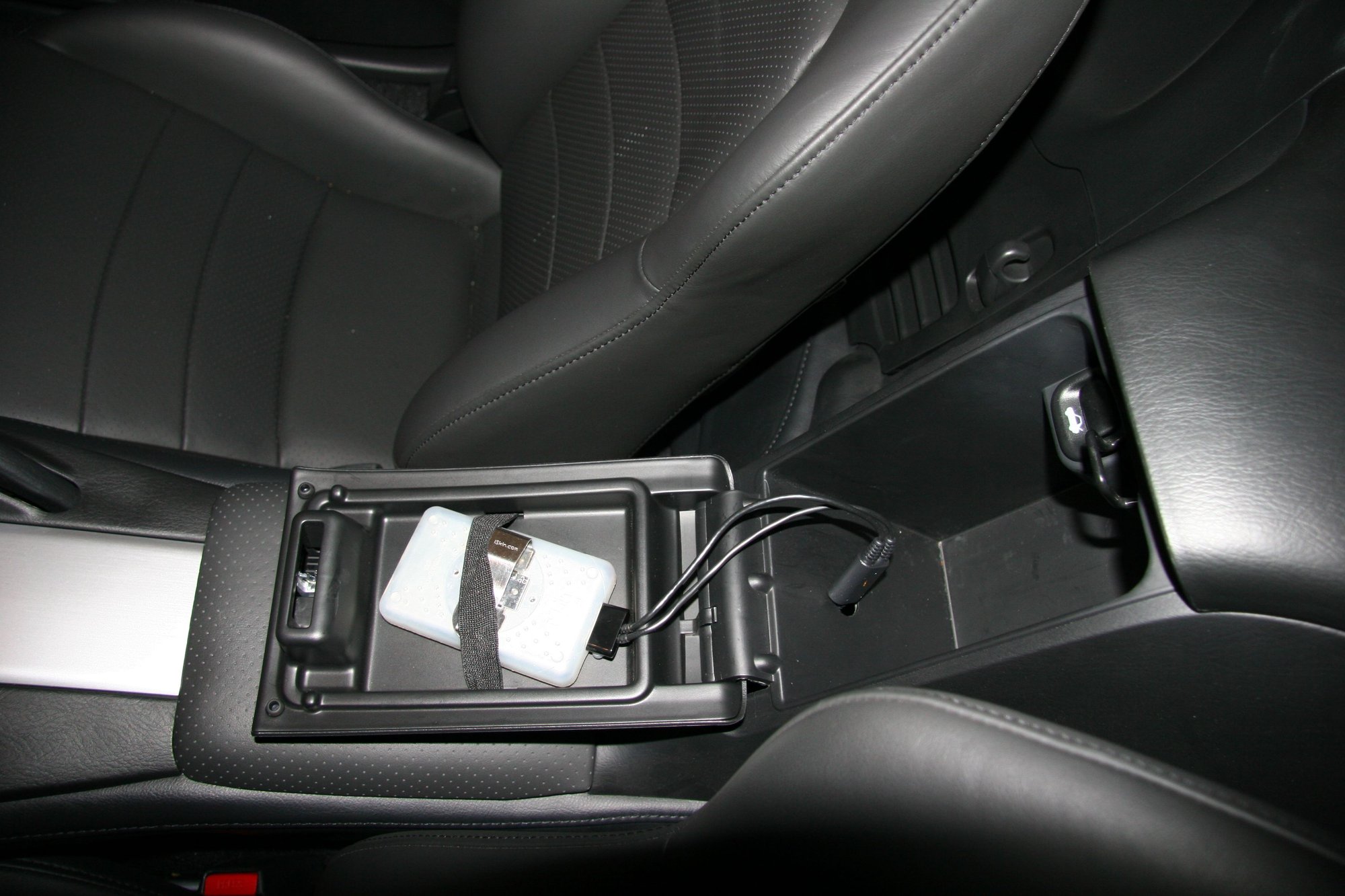

Ipod Adapter: Alpine KCA-420i
The sub box by William Laurent at azcartoys.com is awesome. Fits perfectly and sounds great.
Trickiest part was trying to fit the large Alpine amp somewhere without sacrificing the usability of the trunk. Mounted on a board and then mounted the board to the left of the spare. Now it had to overlap the cover for the spare which makes it impossible to remove the spare - but, the solution is to keep a phillips screwdriver in the car, allowing me to temporarily remove the amp to slide it aside to get to the spare. Problem solved.
