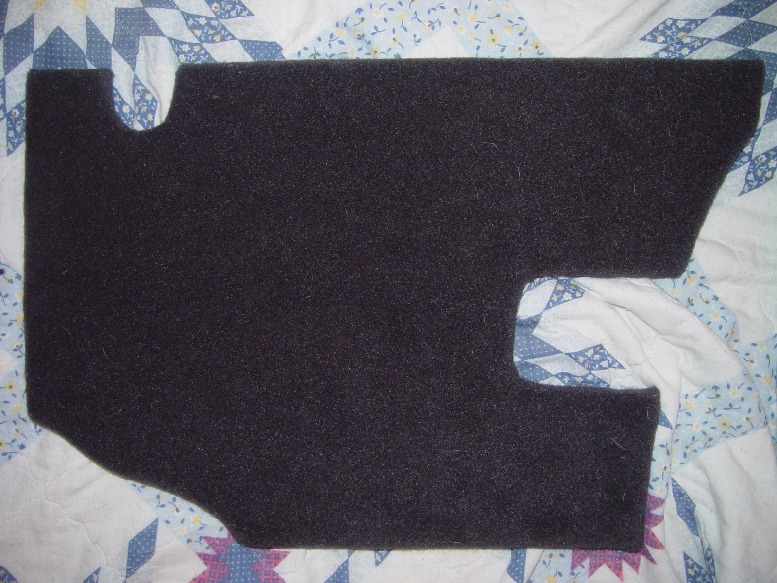

Could anyone please give some rough measurements that I can work with to make a rack like this myself? I want to put my amp in there as well so it's plenty out of the way.
If someone could provide the roughly rectangular piece of wood that is needed to start, I'll make the necessary trims myself based on the pics I see here.
Thank you in advance!

I made a cardboard template to test fit. basic rectangle is 19" x 16"
though in the end I think I made the rack a little longer than 19" at the
right rear to wedge it in against the spare tire. Anyway, just cut out a
piece of cardboard, stick it in, cut away wherever you need clearance
(roll bar, filler neck, gas gauge sender) until you have what you want.
