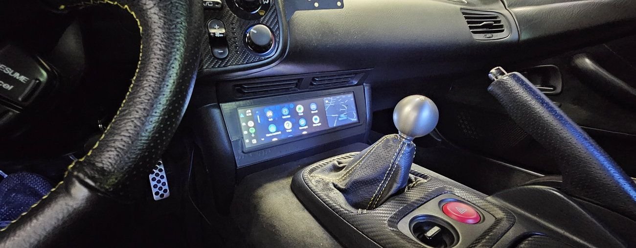

Yeah I did that here: but at that point the 8.8 is better because it fills out the space more. If anything for the outer mount a taller screen could be used. Like a 9.5" or something. haven't found one though.
The 7.9" mounted from the front might allow the use of the radio door, which would be sick

Oh, i think i misunderstood you. so your saying in front of the inner bezel but still behind the door?
ok so, MAYBE. measured and the width is good but height is extremely close.

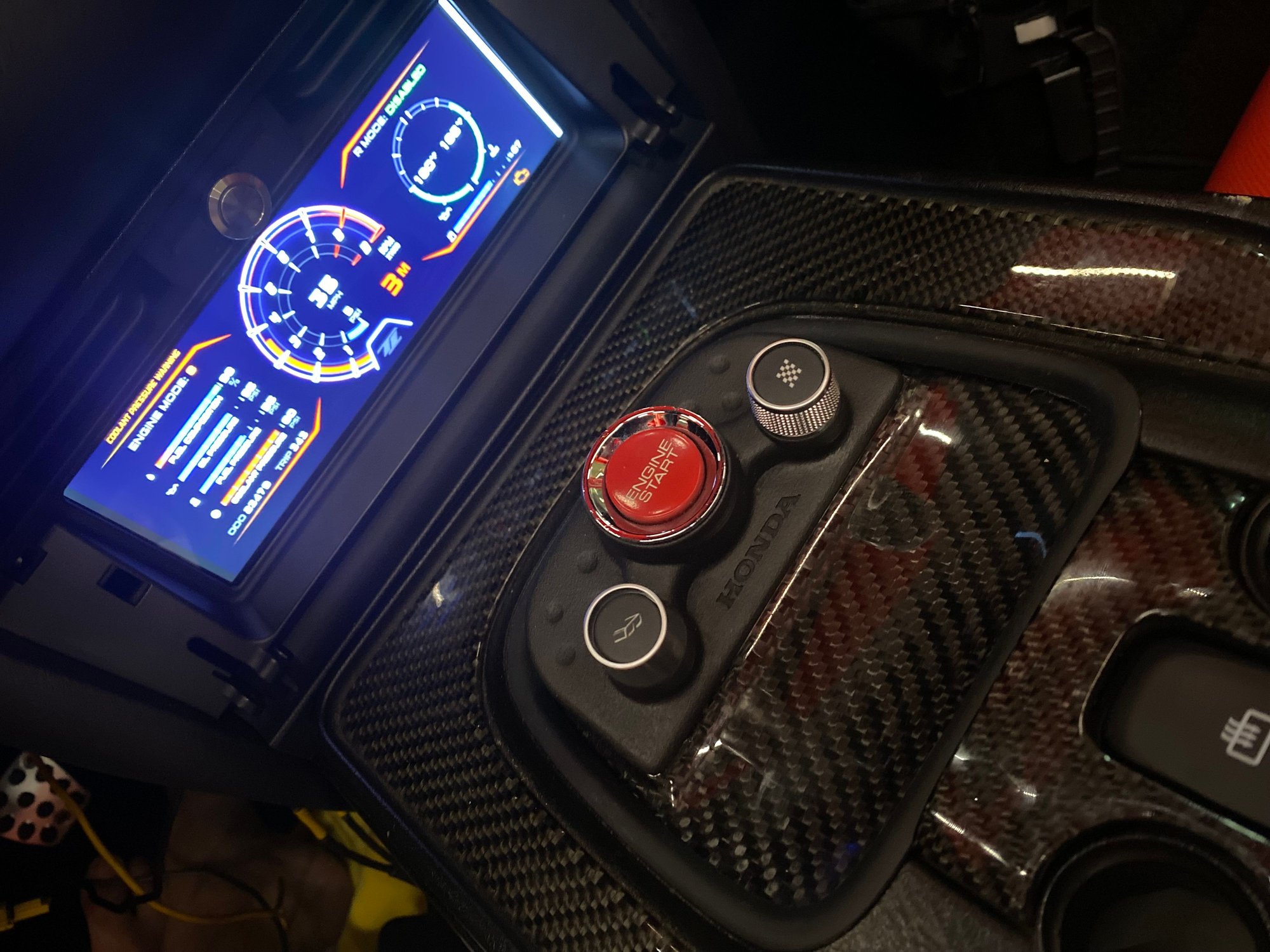

I swapped displays with waveshare 7.9”, with screen motherboard relocation to make extra room for display ( it fit with minor stress on the screen ) I think with little sanding to the dashboard it will fit perfectly
