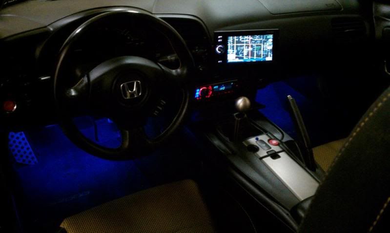

The N1 does not have enough clearance when it motorizes out from the unit to clear the shift knob in neutral and when it flips up, it doesn't slide out far enough to clear the lower right part of the dash bezel area
I spent a LOT of time looking for one to modify to fit, and I couldn't
So I installed a double-Din!
I didn't like the look and having to look down at the screen so I opted with an aftermaket head unit and this for Nav
It does everything I wanted (Video, Memory card playback, Nav, Bluetooth, etc) and integrated it into the axillary input on the head unit to make everything fairly seamless
How did you mount that? Modifry bracket?
