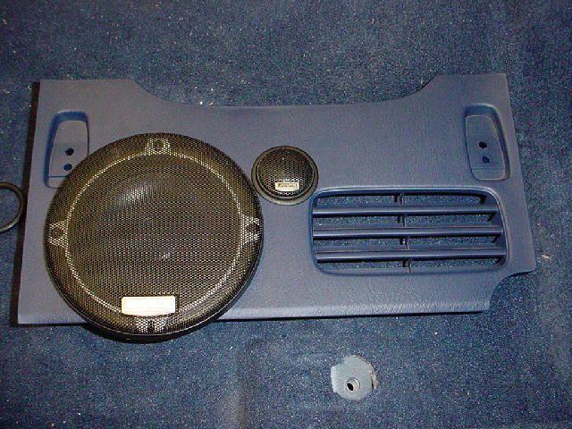

I have Alpine 177a's in the front and the 137a's in the rear and these are pretty close to the ones you listed with regards to the size.
The fronts fit fine, you'll need a bracket/spacer for them to fit without hitting the window or just cut the back out of the basket like I did...its a prefect fit. As for the rears that takes a little bit of work and 'cutting' to make those fit, but they will fit
Here's a few pic''s how I did mine:
Any questions let me know...

yeah you'll be fine... you will have to dremel away a little metal to make those rears fit but nothing structual. You'll need a bunch of those little tiny cutting wheels
