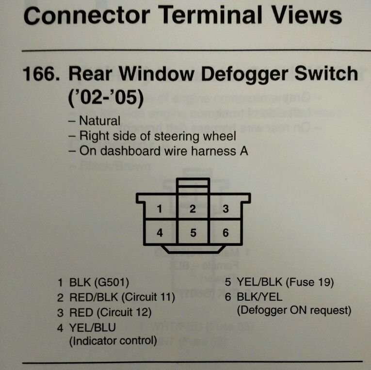

If you do can you please look up the diagram for the defrost connector on the cluster bezel and post a picture of it. I have the 08-09 manual and it's not in there. I've looked. I'm not asking for the book or pdf to be posted so mods please don't take this down.

Different connector but I believe I can use this. Thanks.

Didn't work for what I need it for. The connector I'm looking for is the 6 pin connector illustrated in this post.

Sorry, been away on vacation! HTH
