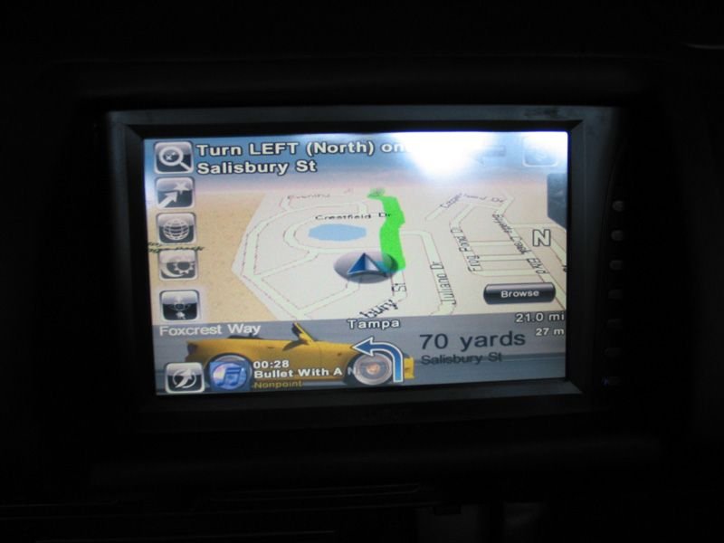

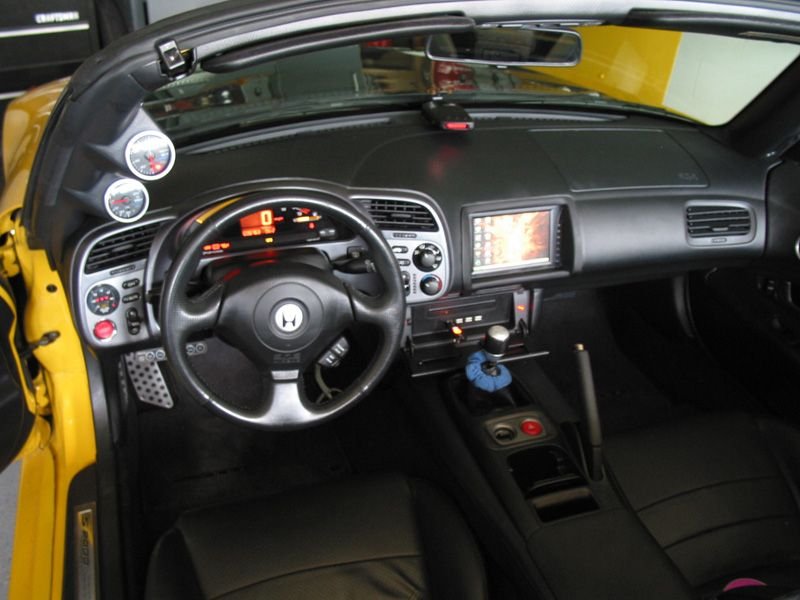

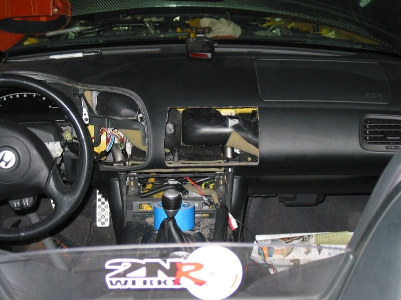

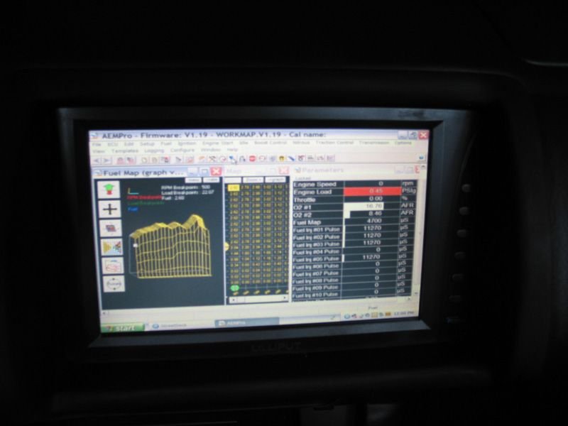

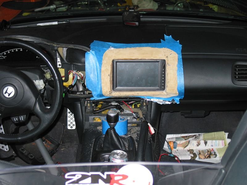

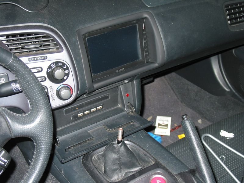

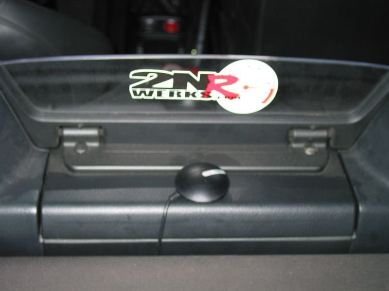

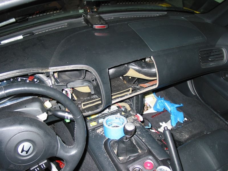

I just finished installing a computer in the trunk and a 7" touch screen in the dash. The bezel for the screen was made out of 1/4" plywood and fiberglass. The DVD player and USB hub are mounted in 1/2" MDF and secured to the factory radio mounts. All in all I'm pretty happy with the results, a few things could have worked out better, but for my first time I think I did good
