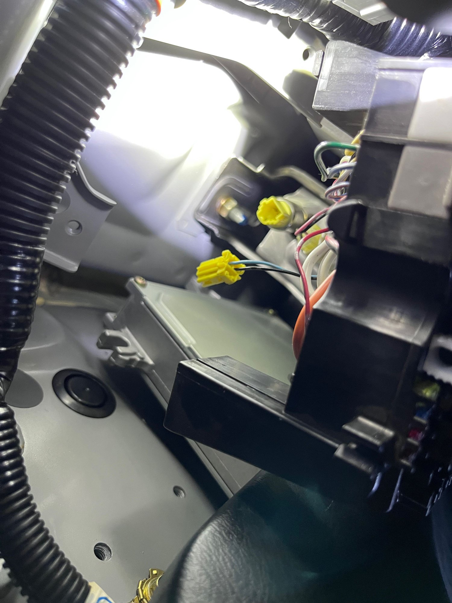

I experienced the annoying problem that the small plastic bumper which is supposed to push the switch when you depress the clutch deteriorates and breaks. Then you can't start your S2000!
Try as I might I couldn't reach up there to put a new one in, so I decided to do a bypass, which solved this problem. Here's my solution for access to the connector - remove the 2 10mm screws which hold your cabin under-dash fuse box, unplug the main bus connector and move the box out of the way. You can now access the yellow connector to your clutch ignition lock switch and unplug it.
Next, bridge the board-side male plug with a small wire. You might want to wrap it in electrical tape to prevent it from working loose.
That's it.
I'm posting this because i was unable to find a good description of how to do this on these forums. Hope it saves you some time!
Viewing the connector
Bridge the male connector which is attached to the fuse box.
