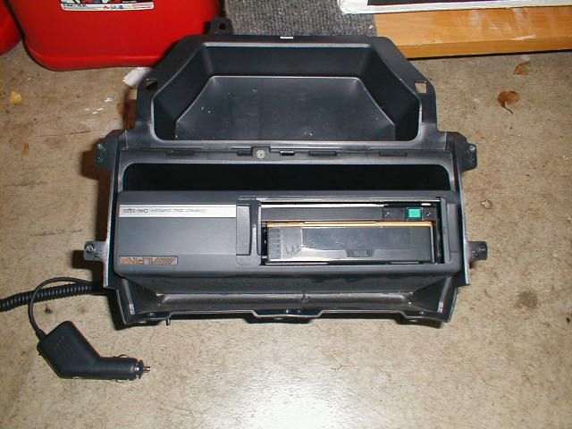

I just got the very first Alpine KCA-420i in florida. Well I got it last week and installed it yesterday. It plugs into the AI net port on the back of the radio, and then plugs into the docking port of a Gen 3 or newer ipod. It supplies power to the ipod and brings the control and display of the ipod to the radio. Out of site, out of mind. It simulates a changer and uses the file function for MP3's to access the ipod.
this thing rocks, search by artist, genre, playlist, song etc.
I have it hooked to the 9538 radio, and couldn't be happier,
Mitch
Here are some pics of the install
My first cool mod. Alpine changer in secret compartment hooked up to factory radio.

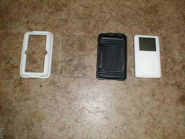

ipod case...teski.com great case. I pulled the pin on the belt clip and ground down the tabs to give me a flat surface for 3m vercro to hold the ipod in place
ipod in pocket

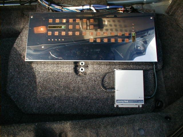

Wiring harness
Finished amp rack in spare tire location. No holes were drilled. I used the spare tire bolt to secure the rack
If you have any questions, let me know
