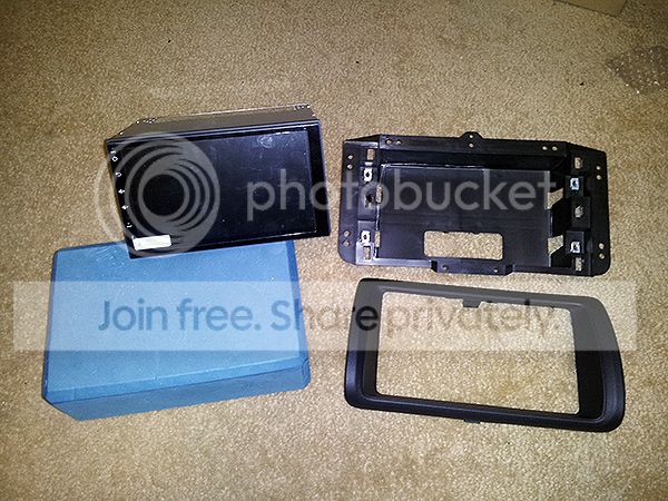

Double Din Android and JDM bezel and cage/box
parts can be found at www.japanparts.com
-7 NAVIGATION INTERIOR BOX: Parts No : 027-020-001)
- JDM PANEL ASSY. NAVIGATION: Parts No : 027-017-001)

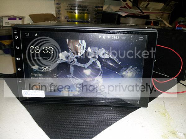

-Tested my double din android deck

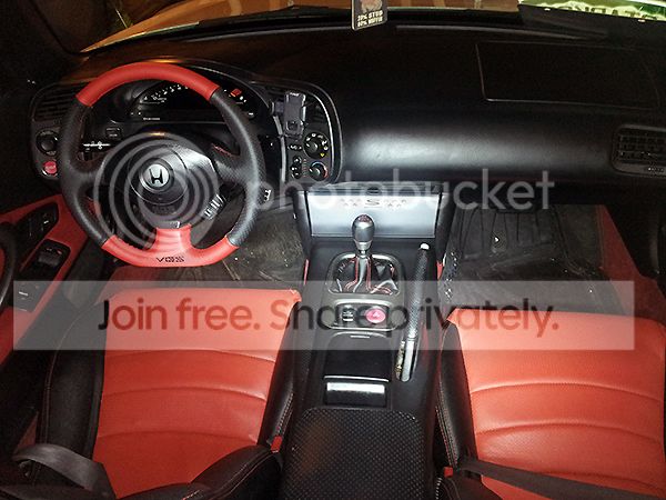

Took a pic of the dash before cutting

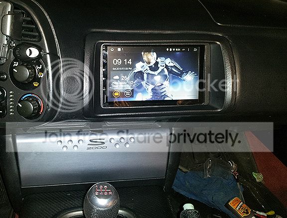

Cutting in progress, trimmed the vent and unmodified airbag bracket.
Test fit/installed
All cleaned up and installed. Also added OEM tweeters and rear speakers.
very nice ! may i ask if you have a pic of the trimmed vents and unmodified airbag bracket ??

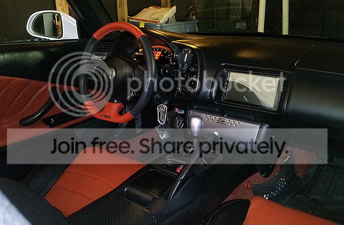

Originally Posted by CyaN.
So, im pretty sure im gonna fit my s2k with tablet. For that, do i need both jdm bezel parts or just front one? Also, is there something better on the market than nexus 7?
Exactly what I did. I did not have to cut passenger vents since the tablet is thin. The reason the Nexus 7 is the tablet of choice is because of the custom software available designed specifically for car use.
