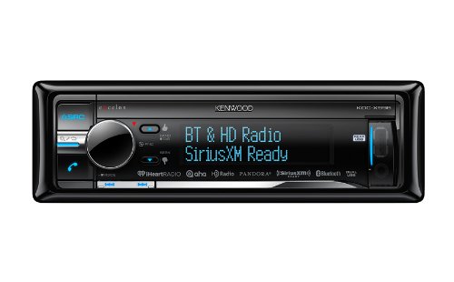

Kenwood KDC-x998
https://www.amazon.com/Kenwood-eXcel...ds=kenwood+998
Old Jul 10, 2016 | 03:19 AM
Jones Auto's Avatar
Joined: Jul 2016
Posts: 6
Mikee can you close the radio door with the Kenwood unit. I'm looking to upgrade my stereo.
I have this radio and the door closes fine.
