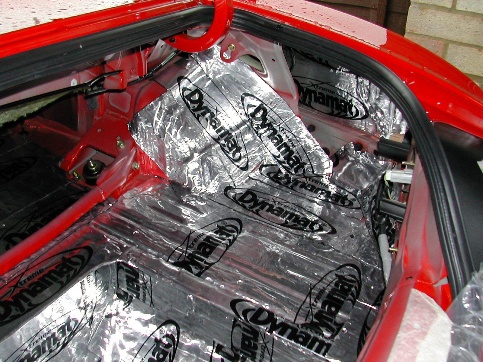

I slapped three coats of quietcoat onto the tray overnight. I removed the tray having damaged one of the retaining clips (in the darkness I assumed it was a simple pull out plug, whereas seven of them are the ones with the push-in centre bits) to make the coating job easier. ON the way into work this morning I was contemplating whether to use a bit of dynamat on there as well - I'm paranoid that the source of the headasche-inducing resonance is the tray (I dynomatted the trunk and the spare tyre well six months ago - see ICE photos in sig). I think I'll place dynamat squares across the centre of the tray and not bother with the much smaller squares at the edges of the tray. Then its up with the seats and carpet and a few coats under there - the effort I go to having relieid on some owners' advice that the T-1R does not resonate
