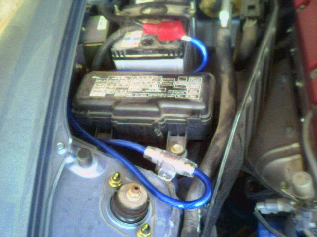

Originally Posted by PJK3,Jan 17 2005, 12:56 AM
my question:
looking at your power wire run -- it appears like you're running it towards the front of the car from the battery... and over the heatshield...
where is it going? there's a nice little grommet to get you in to the vehicle behind the battery.
i'd also be a little concerned about exposing the wire (even in loom) to the temps near the exhaust...
and i think they are suggesting you line the point of the board/well interface where they contact each other with the foam.
couldn't pass the 4 gauge wire through that grommet behind the battery and yes it goes right on the headers !!!!!```` facing no problem with heat
(loom?!) you mean the black shield for the wire ?!
and about the foaming thing,, does it stick to the well ?!
in case of removal,, will i face any problems ?! ``
THANKS
Old Jan 17, 2005 | 04:10 AM
  #23
darkknight1999's Avatar
Posts: 11,288
From: Hopedale, MA
You should move that power cable so it runs over the top of the block. Its going to melt being that close to the header sooner or later. I've seen headers get red hot. You don't want your car catching fire,... that would suck!

thank you guys for the advice...
here's the wire moved

Old Jan 24, 2005 | 08:22 PM
  #30
Posts: 11,288
From: Hopedale, MA
Much better! Good job!
