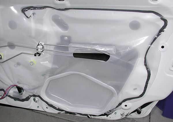

I promised some photos. I figure we can use all the images we can get. Did the passenger door today. Took me over four hours. Now that I sort of know what I'm doing I imagine the driver's door will take maybe three.

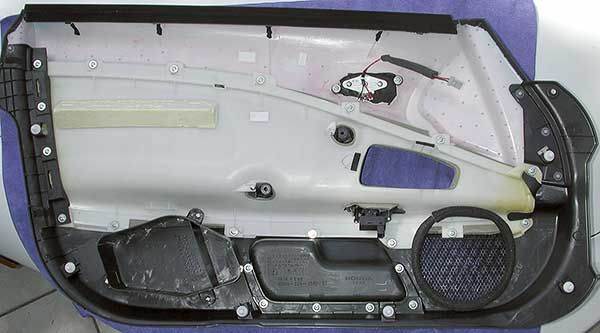

The original door liner adhesive is nasty goop. At least Goo Gone wipes it up nicely. Same for the RAAMmat adhesive, felt very similar. I didn't need a roller because the RAAMmat conforms so well (thin aluminum). I only used one layer plus foam but you could layer it for more damping.
Some of you guys showed such clean pro matting. I felt lucky if I got enough coverage!
Here is the door after some Goo Gone wiping

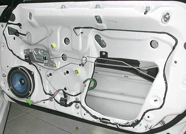

I was fabricating some aluminum screen material to support the large opening but I gave that up. Not really needed with the aluminum-backed RAAMmat. And I was getting too many aluminum splinters! Note there is also no way to really seal the door compartment completely. The door lock and opening control arms have to pass through.
Here's the virgin door skin.

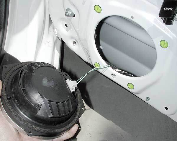

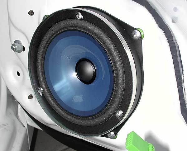

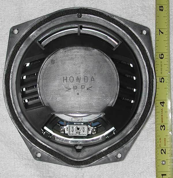

Our pathetic stock speaker.
How did you guys trace the speaker for MDF rings? It doesn't sit flat for tracing (I think even if the speaker is removed from the ring?). I may not need them but I took this photo as a reference (I could enlarge to match the scale and then trace on MDF).

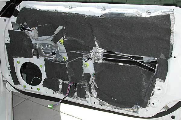

Here is my matting. Not nearly as seamless as some of your installs.

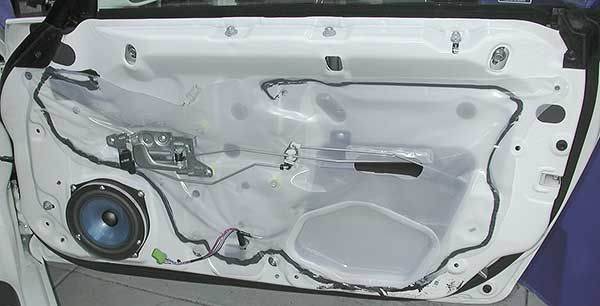

Here is the final foamed door.

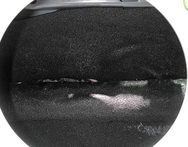

Here is the mat-and-foam on the outer door skin, seen through the speaker opening.
I damped the lower half of the door and the cross brace.
I seem to have neglected to take a photo of my matted door skin! You're not missing much. I didn't foam it, just matted where it seemed to need it.

That's a great start! Are you planning to put some mats at where you'll be mounting the speaker?
Also, have you water tested the foam? Some foam soaks up water and hold them and cause interior parts within the door to rust. You may want to use rubber pads behind the speaker instead of foam

Oh, for the MDF ring, I traced the speaker basket onto the MDF just with a pencil. I found my speakers were a bit bigger than the factory, so I had to enlarge the ring a bit. I traced another, marking the middle as best I could. Then I traced my speaker using the same center. Then, I expanded the areas that needed to be and cut to fit. I may have made it a little too big on my passenger side, because I couldn't get one clip back in, but the door doesn't have a problem and you would never know without specifically looking for it, so I left it for now.

I cut out the middle of the speaker basket and reused it with my aftermarket speaker instead of making an MDF ring. 7+ years ago
