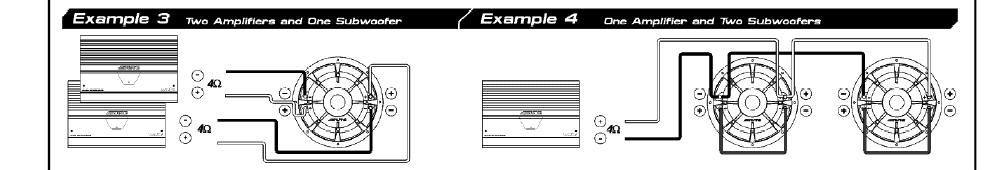

I can swap the amp to the dual 2 ohm. So i guess this is the best way to get good power out of the sub without problems right?
Old Jun 27, 2003 | 09:46 AM
mgiang7's Avatar
Posts: 714
From: Arlington
most of the suggestions we've made will not cause problems, just not full power.
if you can swap anything, swap the subwoofer for a dual 2ohm instead of a dual 4ohm.
alternatively you can keep the dual 4 ohm sub and get an amp that is stable at 2ohm mono. most mono amps will do that, some stereo amps will do bridged 2ohm mono (but not the cheap ones).

um, no...if you wire it in series 4+4=8, when you run your amp in mono it sees half 8/2=4.
Old Jun 27, 2003 | 12:36 PM
mgiang7's Avatar
Posts: 714
From: Arlington
uh, that makes no sense.
ok so we all agree that wiring a dual 4 in series = 8 ohms?
once you wire it that way, the amp will always see 8 ohms, the fact that you're running a stereo amp in MONO does not change the resistance on the amp it only increases the amount of power @ 4ohms
the only thing that gets divided by two would be the power, instead of putting out 420 @ 4 ohm, it would be ~210 @ 8 ohm.

Series: 4+4 = 8
Parallel (4*4)/(4+4) = 16/8 = 2

Read your instructions that came with the amp or call a stereo shop. Both will tell you your amp will see 1/2 the ohms when you run it in mono.
Old Jun 27, 2003 | 01:09 PM
smyroad's Avatar
Joined: Jan 2001
Posts: 3,004
From: Bowie
You could get a second sub. 420 watts from the amp, 210 watts into each sub and only 105 per coil.
