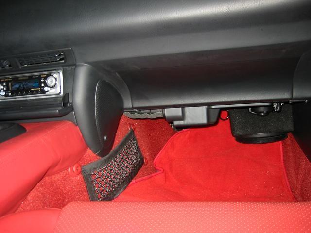

At least one owner cut out the floor under the seats (and some of the door sill box frame) put some 10's in the floor. Others have put small 6" woofs in tubes under the dash. A few have put a sub in the passenger footwell area, some on the right side up against the 'wall', and at least one in the angled foot rest area, like this.

6" sub JL w/ focal utopia's 6.5" components, both running off my PPI 4100
With a combo of both the 6.5", and 6" sub.. it really pounds for what it is... i'm very satisfield with this set up.

My JL 6W0 FINALLY came in so I'll be looking to creatively fit it into the cabin. Now that I have it in hand I can get a feel for what locations will work and what will not. Actually designing and making the custom enclosure will take a little longer.
Here is a good thread about in-cabin subs, including two JL 6W0 installs
s2kmugen, can a passenger get their feet behind (or I guess actually "forward" of) your box? I know for tall-ish passengers it feels more comfortable to have your toes tucked up forward of the A/C component.
And one more question, do you have a grill protecting the sub? I noticed that JL doesn't include them so I wonder what you did to prevent toe holes...
