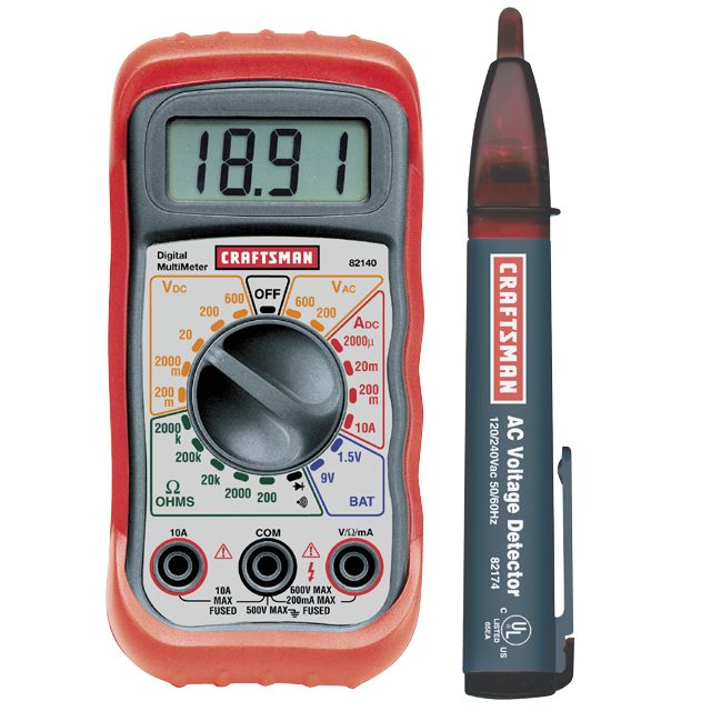

Just to add....for other users.....this is the BEST tool you can have when dealing with car electronics...the amount of uses it has is limitless.
IMHO, this is one of the better ones....
Inexpensive, and works great.
Sears: Craftsman
Sears: Craftsman
Sears: Craftsman
Sears: Craftsman
