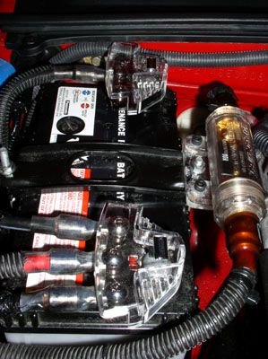

4 Ga. Power wire disconnected until DVA-9861 arrives.
Thraak
108 sq. ft. Dynamat X-treme
Monster Cable Interconnects/Battery Terminals
Streetwires Power Distribution/Fuse Blocks
Streetwires 1 Farad / 25 volt electrolytic capacitor

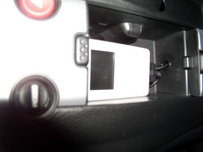

Oh, and the DDC which I now have unmounted at the moment, in the flip down center console is a tweaker's very happy dream!!!
