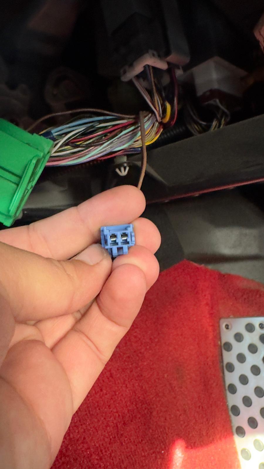

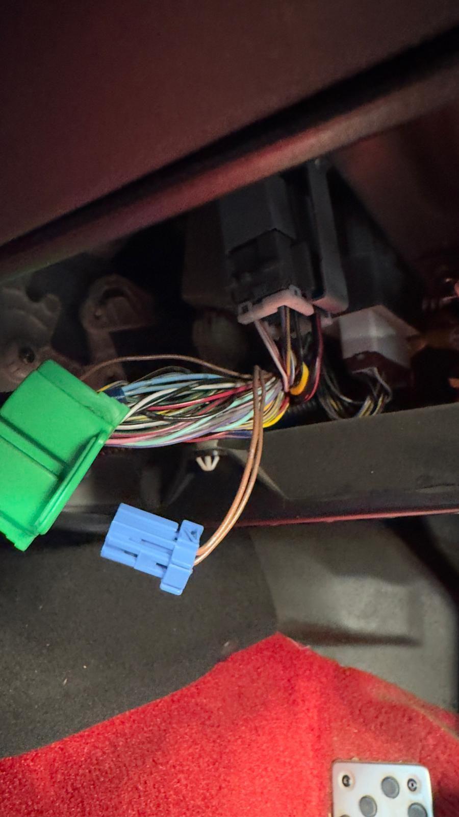

Hello there,
On my 2002 RHD model I do not have the H morse beeps when entering the car. Furthermore I can drive without seatbelt and no beeping aswell. Same with headlights , if I happen to forget to keep turn them off when I leave the car there is no beep.
This morning I noticed a cable floating around
Green thingy is just to hold the cable , no electronical part in there.
Could this be the issue ?
I bought the car 3 weeks ago , only thing about electronics the previous owner mentioned is that he replaced the battery.
Thanks in advance
Have a nice day
Jay

I managed to fix my issue by checking the door switches.
The driver side doesn‘t seem to work properly anymore so for now I took the passenger one and put it on the driver side.
the morse beep, headlight beep etc is now working again

blue plug is a test connector. try flushing out the bad switch with contact cleaner or wd40 will work also.
