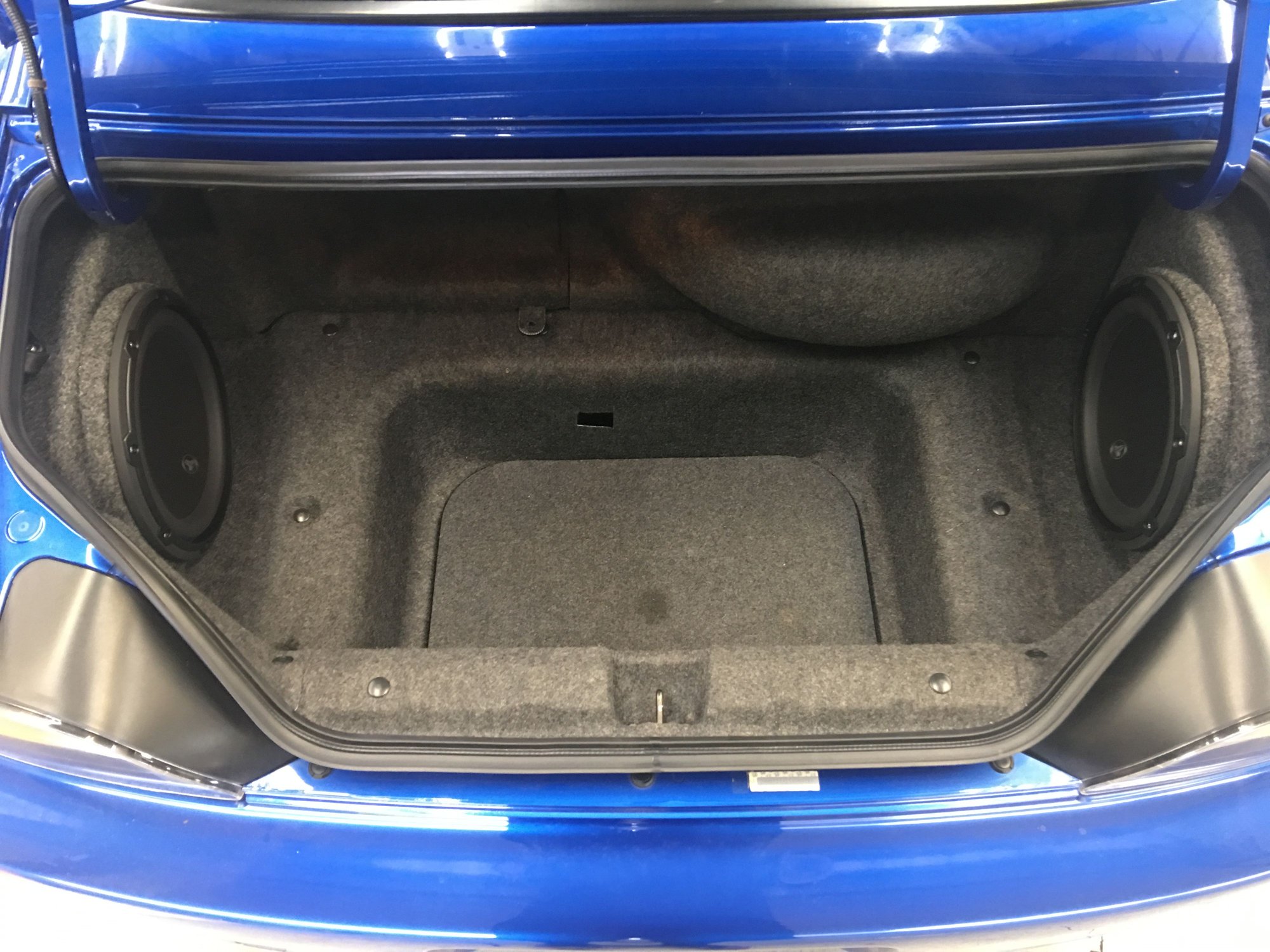

I recently installed two JL w3v3's with a Rockford R1200-1d in my car and it feels a little lacking. I was wondering if anyone has any suggestions for getting more "punch in the chest" bass feeling.
The subs are in sealed boxes and I also installed dynamat in the trunk. And I have the alpine cde-hd149bt head unit.
Maybe different amp?

For Fast AP2 - I know nothing about the speakers you are using as I have no desire to damage my internal organs with chest-thumping bass. But you might want to double-check the cut-off frequency of the cabinets; they look pretty small in the photos. I assume you're using AWG 2 or 4 for amp power?

Check phasing first, as it's easy to do. Disconnect one speaker and see if the bass gets louder or quieter. If running on one sub is louder then reverse the wires on the speaker you just disconnected. Of course be careful with the wires to make sure they don't touch anything when you're doing this test.
Checking the cut-off frequency will either require some sophisticated testing gear or speaker design software to tell you how big the cabinet should be. As osu1978 mentioned, cabinet size is critical and can make a good speaker sound bad. You may be able to get a rough idea of cut-off frequency by using a test CD or a smart phone app to play low-frequency tones through the system. Look for a test that "sweeps" the frequency from maybe 150-200 Hz down to 20 Hz and listen for when the volume drops significantly. Bear in mind your system might have a high frequency cut-off of 100 or 120Hz, so if you do a 200Hz and down sweep the volume will be lower at 200, get louder around 100 or just below, and then maybe drop again as the frequency goes down. You want to compare the loudness of the 40-60 Hz range with the loudest part of the sweep. I would think the 40-60Hz range should be the loudest part of the sweep. If it's not it sounds like the enclosure might not be the best size for the speaker.
You may also be able to check on-line and see if the speaker manufacturer provides optimum cabinet volumes for their drivers. Many do. Look for the size they recommend for a sealed system and if yours is more than 20% smaller it might be the problem.

Ok so I checked out the different suggestions you guys gave.
-head unit is set correctly. Not cutting out low frequency to the subs.
-checked wiring from amp to subs and everything is where it should be. I have two 2ohm subs wired at 1ohm.
-I'm thinking it has to do with enclosure size. JL recommends sealed enclosure of .625cf and I have them in .38cf boxes...

Is that .38cf before installing the woofers, or after taking into account the volume taken up by the woofer cone and magnet? If the JL recommendation was the smallest box you could use for adequate performance then you could be on the other side of the "sweet spot". If, however, the .65cf was for optimum Q, and your .38cf is net, I don't think it would be a dramatic difference. But it might be worth cobbling together a .65cf box and throwing it in the trunk as a reference point, compare it (by itself) with the other sub (by itself).
