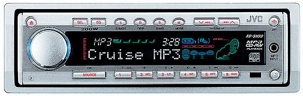

Head Unit: JVC KD-SH99 - $270

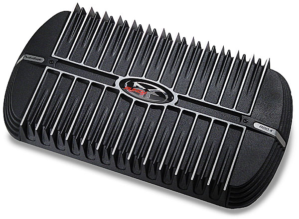

Amp: Rockford Fosgate 800.4 Amp - $320

The difference in price was extreme, and I really don't need all that SPL. I want a tight clean sound. Picked up my 800.4, its paper rates it at 1216w all driven into 2ohm load.
My headunit and PAC arrive tomorrow and the install begins. I am going to wire the front channels to the MB Quart giving them 100rms each, and then bridge the rear two channels mono and feed it into the sub giving it 400w rms. I am using Stinger stuff for the wiring and the 1 ferad cap. More info / pics as it progresses.

Yesterday I got the amp up and running w/ the internal speakers, the JVC head unit installed and the PAC functional. The amp is not in its final location because the trunk is way not finished. We begain laying the fiberglass. We finished 3 layers today. At 3 layers, before we triimmed the top of the box, it weighed in at 11lbs. Pretty nice.
