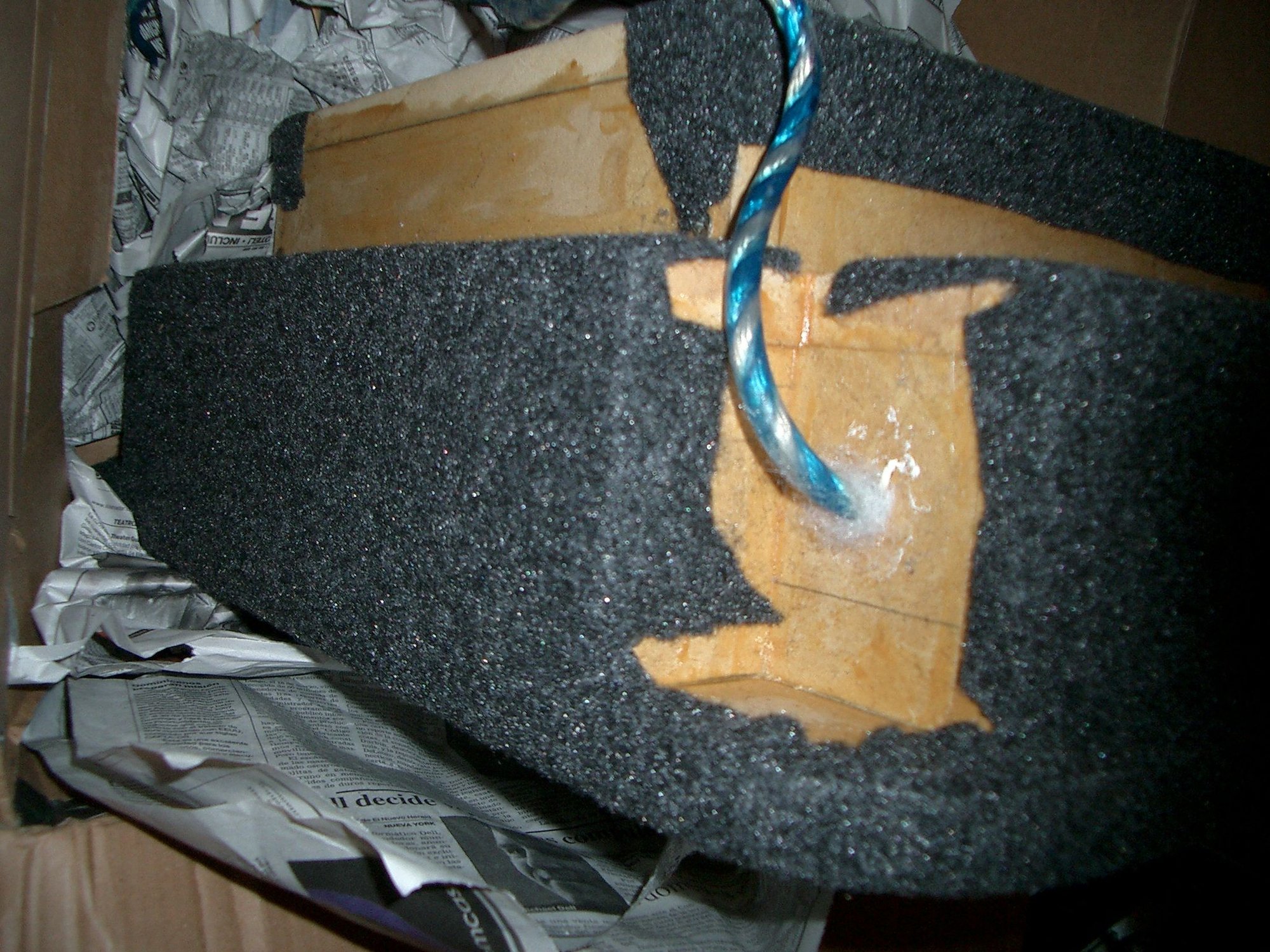

A question about phase... the sub and box were purchased from a forum member (the seas lotus... I think you may have his Alpine amp ) and the sub is hardwired, so I don't know for sure which color is positive/negative (I assumed Blue->Positive, Silver->Negative). As the sub is in the trunk with my amp, does it really matter if the wires are reversed (or does phase even matter with trunk subs)?

Check out this link for frequencies in tuning its from the FAQ. Set your LPF to whatever frequency you want the sub to hit. I have mine at 80htz. I have my cross overs set at 60htz, even though the manufacturer claims 45 htz frequency response, there is not much to the sound below 60 (can barely hear hit, but you more feel it.... and that is what the sub is for).
https://www.s2ki.com/forums/index.php?showt...0&#entry5867463
Pics please on the sub box terminals. Why not PM him?
John

I had sent him a PM about another issue, before I thought about the phase issue, but hadn't heard back yet. Since he sold the S2K, I imagine he's spending far less time here.
For the sub, there is no terminal, just a wire protruding out (siliconed on both sides to seal I was told). So you have an uninterrupted wire straight from the speaker to the amp. Here's a picture:

As far as Phase goes.....you only have to do a listening test.....and pick which one sounds the best to you.
