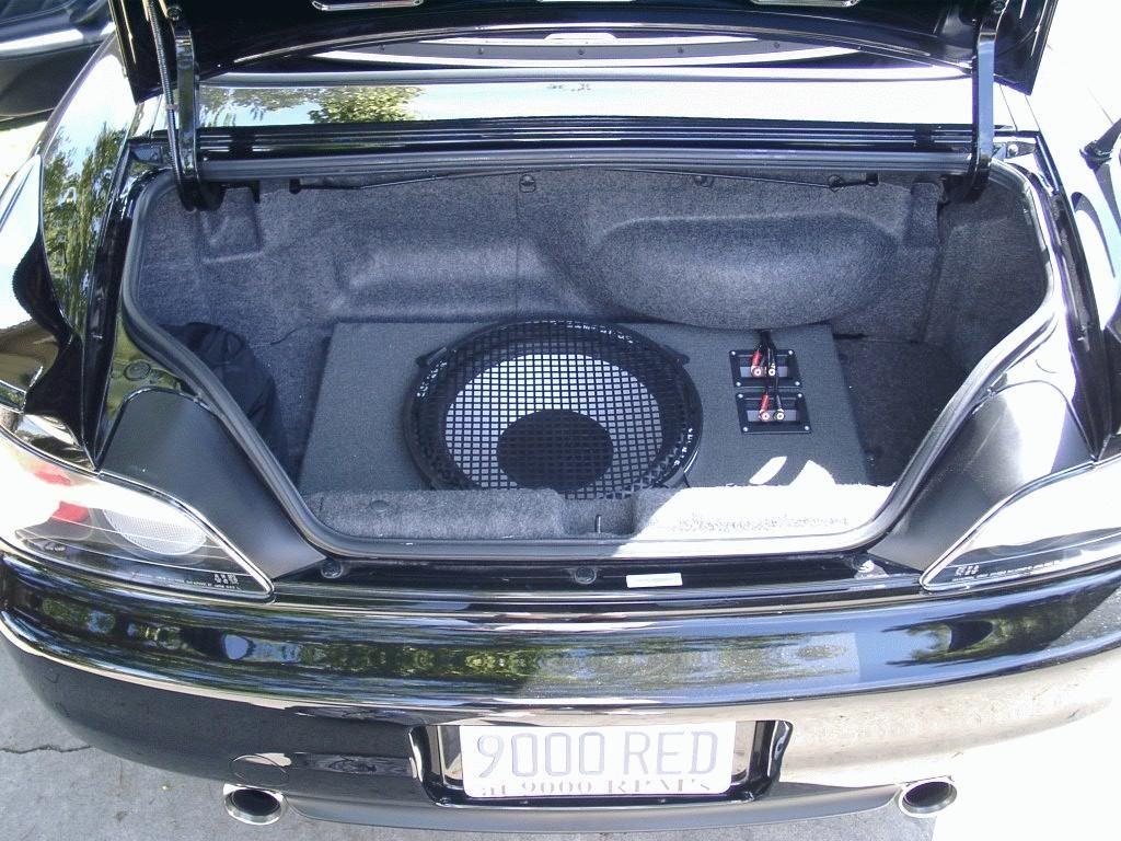

I'm running 500W RMS power with a 15" Blaupunkt overdrive dual voice coil woofer at 2 Ohms off a Kenwood mono sub amp. I never trust a stock electrical system with anything over 300 W, especially with the S2000's small battery. I put in .5 Farad capacitor by strike, and it sounds great even when hitting hard at high levels....when the amp has plenty of juice the Sub won't sound muddy. I am very pleased with my system....

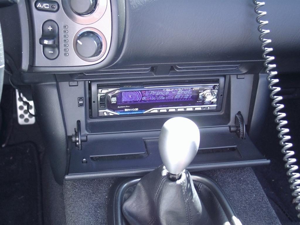

Kenwood Z919 MP3 Head unit
Sony 6 1/2 component speakers...with tweeters installed in A-Pillars
Custom Fiberglass enclosure I built for the tool bay...that is removable if I need it
Amp and Capacitor installed in Spare tire area(Removed)
Going to add the Rear panel speakers by Lucid when Bonus check comes.
All work done by....me!!!

What was involved to install the 15" sub? ..materials, etc... Looks good.

Being an audio enthusiast...I knew from day one that the stock system had to go...quick
I like clean music...but still get the itch for some big deep bass. The Honda sub or the Bass Shakers were not going to work for me. After measuring and playing around with ideas, I knew that the only way I was going to get a decent size sub and still maintain some trunk space was to build a custom enclosure from fiberglass that molds to the tool area. I had never worked with fiberglass before but I did it pretty easily after some trial and error and a big mess.
Buy some thick fiberglass sheets and lots of resin with a couple of disposable brushes. I chose to leave the carpet in the well in case I need to bring it back to stock. Completely cover the area with aluminum foil so the fiberglass won't stick. Mix resin and completely soak both sides of fiberglass sheet with resin. Lay a complete layer...wait 30 min.. and repeat...about 3 more times. 4 sheets thick is pretty strong when dry. Only mix enough resin to do one layer at a time because it drys fast. I used a wooden frame on top for more airspace and to connect the fiberglass to the box top below. Lay it down before you begin and lay fiberglass over it. Make sure you wear gloves and a mask. Here is a link to a guy who has pics of the box he made for his stang.
http://s7.50megs.com/audio.htm
Next, I cut the top of the future box out of 3/4 in birch HD fiberboard. The top and frame have lip around the sides, and sit flush on the trunk. I Then used the speaker template to cut the hole for the woofer and the speaker contacts. I layed this piece on top of the frame after sanding the fiberglass on the frame to make it as flush as possible. Then connect both with some screws and nails. I used minimally expanding Great Stuff from the hardware store to seal the top and make it airtight. Cut some charcoal gray carpet and staple it underneath the lip, and cut out your holes with a razor blade or scissors. Fill the box with sound damping filler( This slows down the sound waves and theoretically adds up to to 20% more airspace) Connnect your terminals and sub. Screw it down and your set. You can order some carpet, filler, and terminals from http://www.crutchfield.com
Total cost about $50 - $80 plus labor. Took me several hours to complete. Make sure you don't make your frame too tall or you won't be able to get the box out of the trunk. Check your sub for its recommended box size first. My box is about 1 - 1.2 Cu. ft., that's why I went with the Blaupunkt because it doesn't need a lot of airspace.
Hope this helps.
